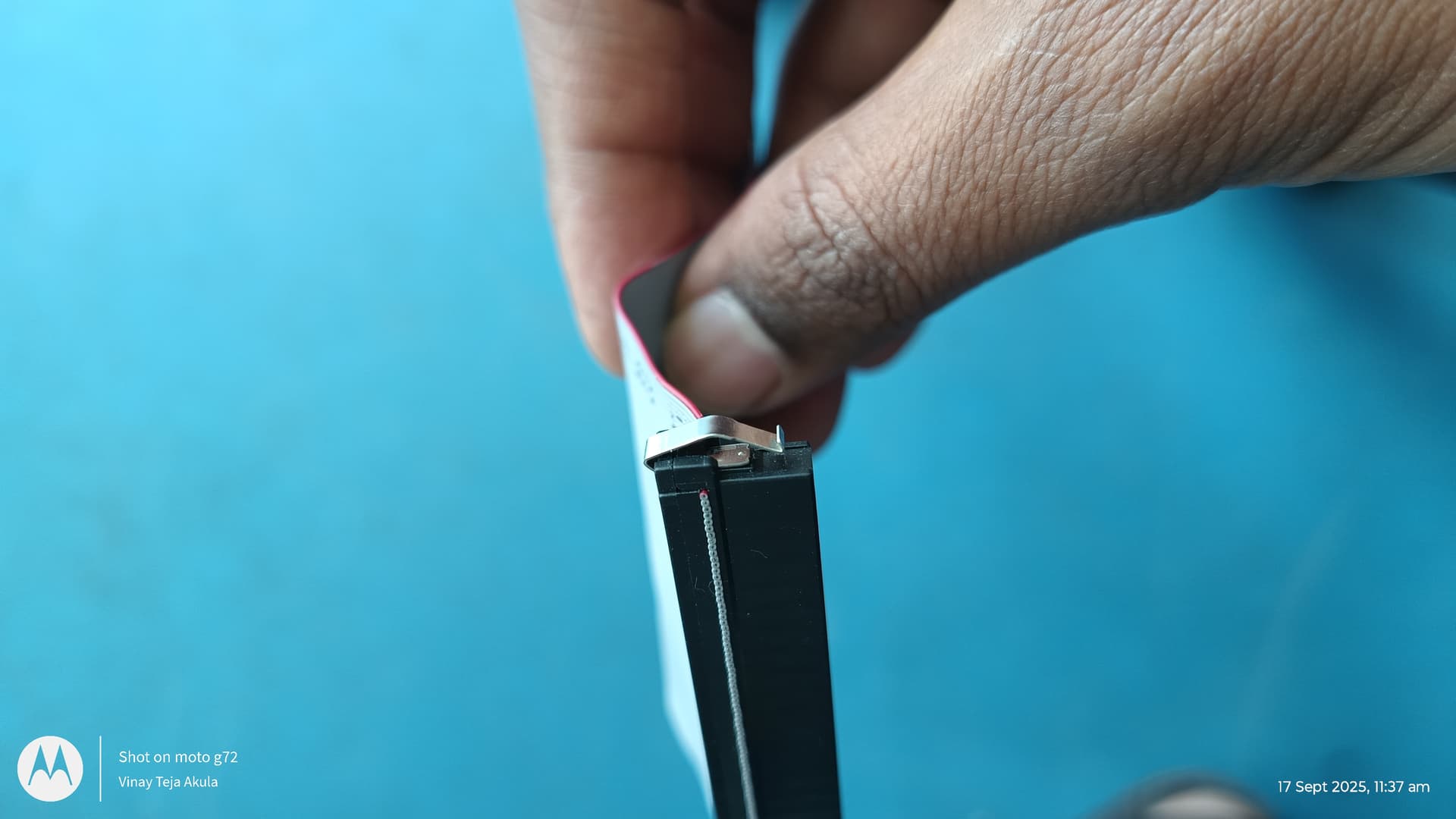

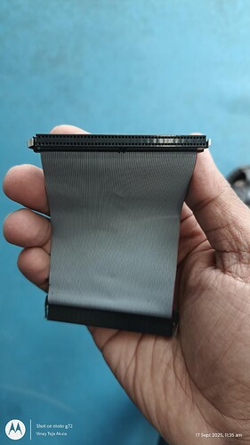

I’m looking to find the 100 wire flat ribbon cable and its respective female mating connectors.
This effort is to basically create the cable which is given in ARM DStream debugger which is a 100 pin male connector

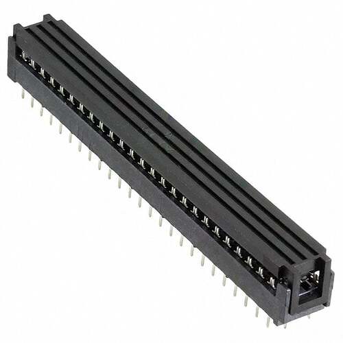

I took a look at our connectors but did not locate a good match. We have a good 100 pin connector on the link below and the datasheet has many possibilities just not a good direct match.
1-5111595-6-ND
> **[1-5111595-6 | DigiKey Electronics](https://www.digikey.com/en/products/detail/te-connectivity-amp-connectors/1-5111595-6/2260722)**
> Order today, ships today. 1-5111595-6 – 100 Position Ribbon Cable Connector Black IDC 30-32 AWG Through Hole from TE Connectivity AMP Connectors. Pricing and Availability on millions of electronic components from Digi-Key Electronics.
[Datasheet](https://media.digikey.com/pdf/Data%20Sheets/Tyco%20Electonics%20AMP%20PDFs/5111595.pdf#Page=33)
Hopefully someone else can locate this if it is available.

Thanks ryan\_urness,
With your pointer I found the below parts. I think this will suffice my requirement
100 wire flat ribbon cable: [https://www.digikey.in/en/products/detail/3m/3749-100-100/1107766](https://www.digikey.in/en/products/detail/3m/3749-100-100/1107766)
100 pins female connector: [https://www.digikey.in/en/products/detail/te-connectivity-amp-connectors/1-111196-6/298980](https://www.digikey.in/en/products/detail/te-connectivity-amp-connectors/1-111196-6/298980)
Can you please look at it once !
