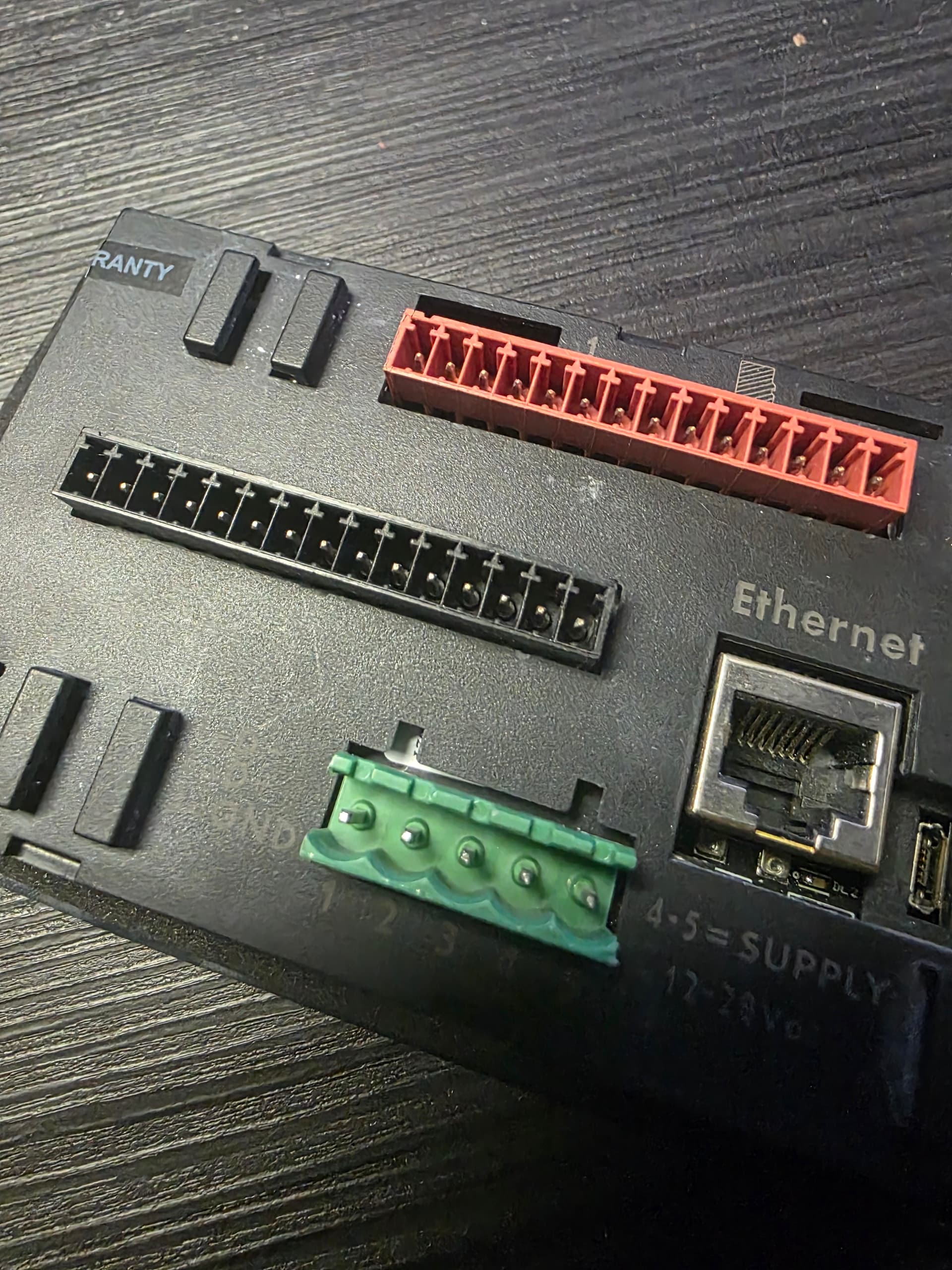

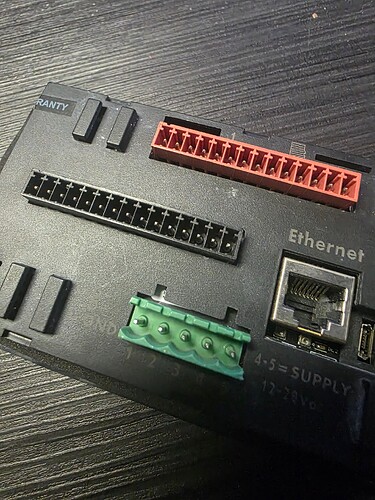

14 and 15 pin connectors for a MECT PLC
I am looking for the 2 connectors for the attached PLC
Wires are screw in into the connectors
Black: 15 positions Pitch 3.50 MM
Orange: 14 Positions Pitch 3.50MM
The previous connectors with the 3.81MM pitch I ordered did not fit
Thanks for your help
Peter
Hi @cpapeter ,
Black 15 positions Pitch 3.50 MM: looks like 900-0395011015-ND.
Sorry, can’t find the orange one.
Here is the Molex Eurostyle ESE 39501 for your reference. However, there are only black and green housing.
If you are looking for the mating connector with Molex Eurostyle ESE 39501.
Eurostyle ESE 39500 and Eurostyle ESE 39503 are the Molex recommended mating parts.
