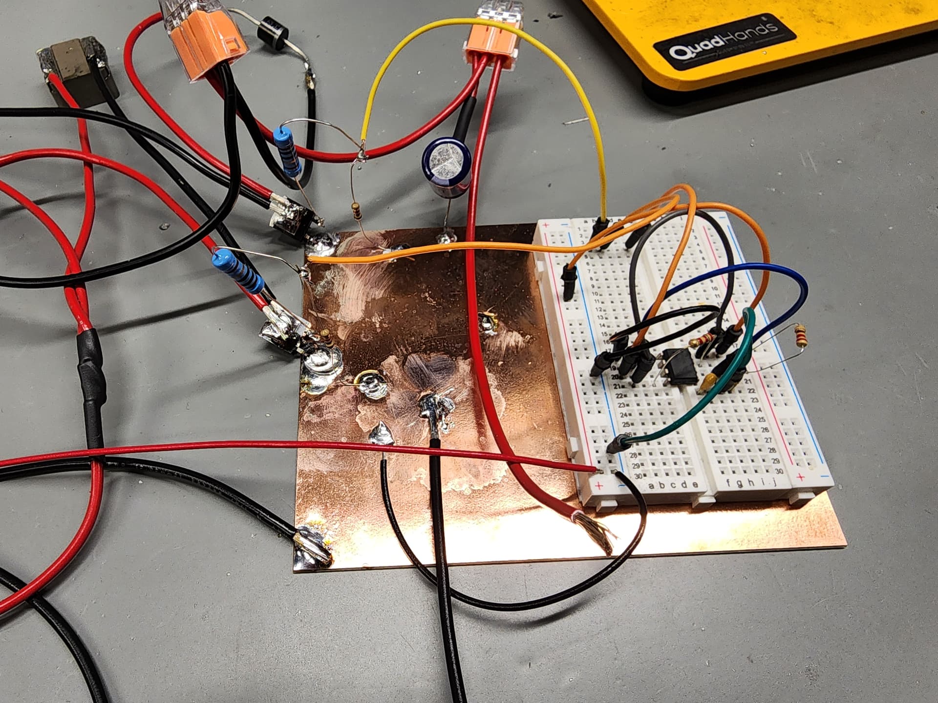

**Author:** ![bryan.tracy](https://avatars.discourse-cdn.com/v4/letter/b/d6d6ee/32.png) [@bryan.tracy](https://forum.digikey.com/u/bryan.tracy)\
**Post date:** [December 27, 2023, 9:09pm UTC](https://forum.digikey.com/t/3-3v-to-24v-dc-to-dc-converter/37350/9 "2023-12-27T21:09:32Z")
Hello everyone,
So the issue I am facing now is the output from the 555 timer. I believe the gate capacitance combined with the max current if the TLC555C timer I am using is not fully charging the gate, I have added a 10Ω (2W) resistor to the gate from the timer output. I also added a 1kΩ pull-up resistor from the timer output to ground. I am getting a sawtooth looking output from the timer, rather than anything resembling a square wave (picture below).
 ![gate pin0](https://global.discourse-cdn.com/digikey/original/3X/7/b/7b886e3c3853edec35045a25aac4cff860f19f1a.png)
Any ideas? I have tried with no resistor and still only 3.3V at the output. I tried using a voltage driver that utilizes charge pumps but it hasn’t worked in the slightest for me. Below is the promised pictures of the circuit, I will make a second post with another wide shot. If you have any questions or comments please let me know!
Bryan
 ![20231227_150008](https://global.discourse-cdn.com/digikey/original/3X/f/4/f4935da4a6a60b74f7d97f9bb70acef804f814c0.jpeg)
 ![20231227_150012](https://global.discourse-cdn.com/digikey/original/3X/4/c/4cd4d959d004f147d36862b9b5d487014aaec9fc.jpeg)
**Post date:** [December 27, 2023, 9:10pm UTC](https://forum.digikey.com/t/3-3v-to-24v-dc-to-dc-converter/37350/10 "2023-12-27T21:10:22Z")
![20231227_145952](https://global.discourse-cdn.com/digikey/original/3X/7/5/75bff33228668bbc15913a18f2d674ce65b2b869.jpeg)
**Author:** ![APDahlen](https://sea2.discourse-cdn.com/digikey/user_avatar/forum.digikey.com/apdahlen/32/40191_2.png) [@APDahlen](https://forum.digikey.com/u/APDahlen)\
**Post date:** [December 27, 2023, 9:26pm UTC](https://forum.digikey.com/t/3-3v-to-24v-dc-to-dc-converter/37350/11 "2023-12-27T21:26:56Z")
Hello Brian,
Beautiful work with an “ugly” design. The copper clad will give you low a impedance ground connection.
As an interim test:
- recommend you use an independent power supply for the 555 timer. Drive it to at least 15 VDC.
- lower the frequency down to the about 10 kHz.
With these changes, you should see a square wave drive on the MOSFETs and the circuit should be minimally functional.
Assuming this works, start looking for dedicated driver for the MOSFET. I don’t think you will be happy with the 555 as it doesn’t have the low impedance necessary to drive the MOSFET gate at high frequency.
Happy Holidays.
APDahlen
