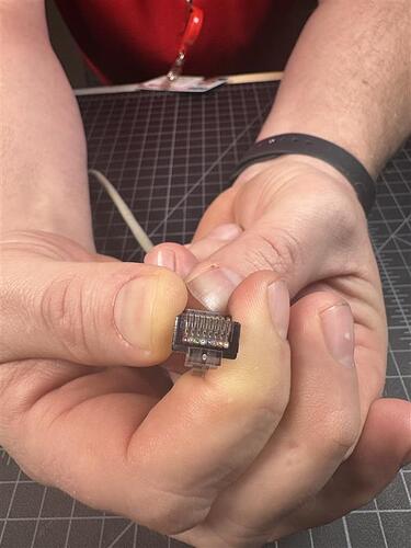

**Step 6.** Line them up and slide into the RJ45 connector. Notice the jacket of the cable is inside the connector as well, this is to make the connector stronger by crimping the jacket. If you look close at the connector, you will see grooves that each conductor goes into. Once again, you should verify the colors are in the correct order. The prong on the connector should be facing down so that pin 1 is on top.

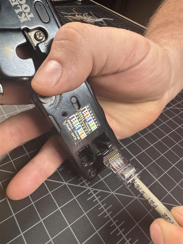

**Step 7.** Crimp it with the RJ45 crimper. There are many types of crimpers on the market, but this specific one made by Klein is my preference because it ratchets and locks meaning you have to squeeze it completely or it won’t release. This ensures that you have a proper crimp, not too much or not enough. I usually squeeze it a couple times just to make sure.

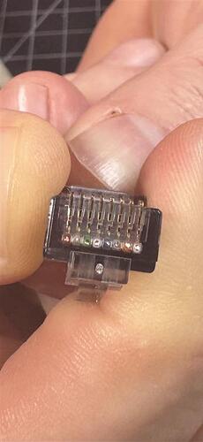

**Step 8.** In this step we will need to inspect the ends to make sure they look right. Notice in the first picture the colors all match up right with the T-568B wiring method. The second picture show the ends of the connector. Notice the colors show and you can see the shiny ends from the copper.
