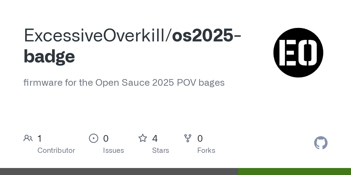

I think I found the firmware, here:
Good find @charliec.sigilvii! I succeeded in flashing this to an ATtiny85 I had sitting around. Looks like they checked in the compiled firmware, as os_2025.hex in that repo. I flashed my chip with:
avrdude -c usbasp -p t85  -U flash:w:os_2025.hex
I don’t have the other parts necessary yet, but I’ll try to report back when I do. I suspect I’ll need to do some trial and error with the chip’s settings as I recall I had this one running at a funky speed previously.
Hmm, this isn’t solved actually. That repo contains the firmware but no information about what fuse settings need to be made.
Oh i love it! @Travis_Foss any chance do you have a pre-programmed one, so we can dump the fuse settings?
PS, thanks for opening an issue! : Fuse configuations? · Issue #1 · ExcessiveOverkill/os2025-badge · GitHub
