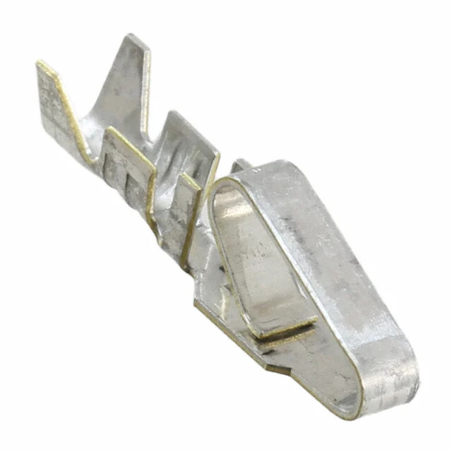

Hi everyone I am trying to find a jumper for this Beosound 4 power board to covert to 115v. The jumper that I used from Krystof for my Beolab 3 is too small so it seems I need a different size. It has square poles and although it is hard to measure given its location it seems perhaps 3 to 4 mm centre pole to centre pole. Any ideas? Thank you!!! Happy New Year everyone

One other non-ideal option would be to make a shunt yourself by using a two-position rectangular connector housing, the contacts that work with it, and a short length of hook-up wire looping from one position to the other.
For example, assuming the header pitch was 0.156" (3.96mm), then one could use the following:
