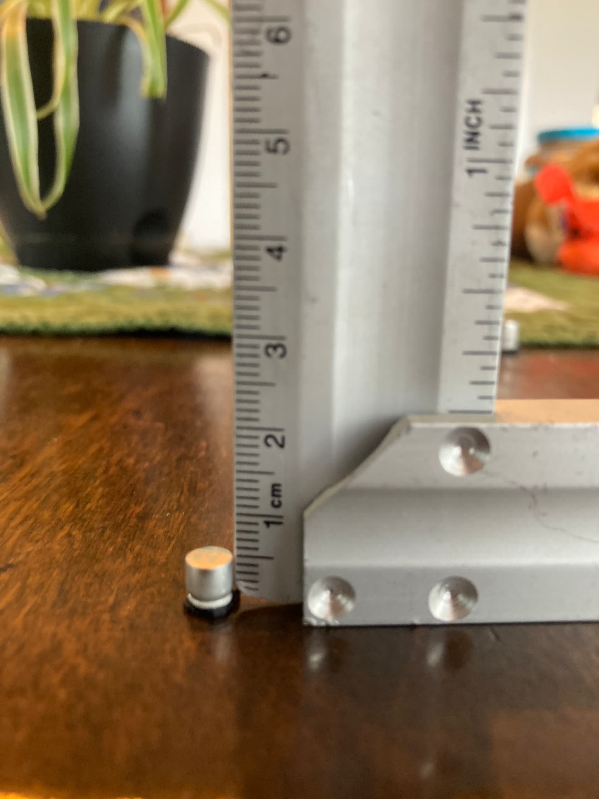

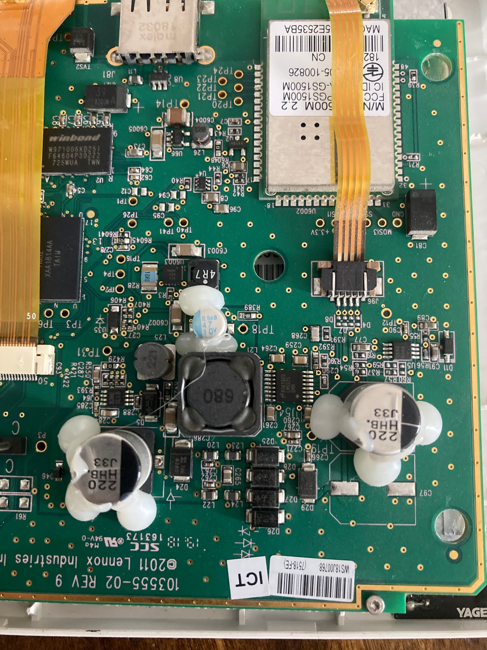

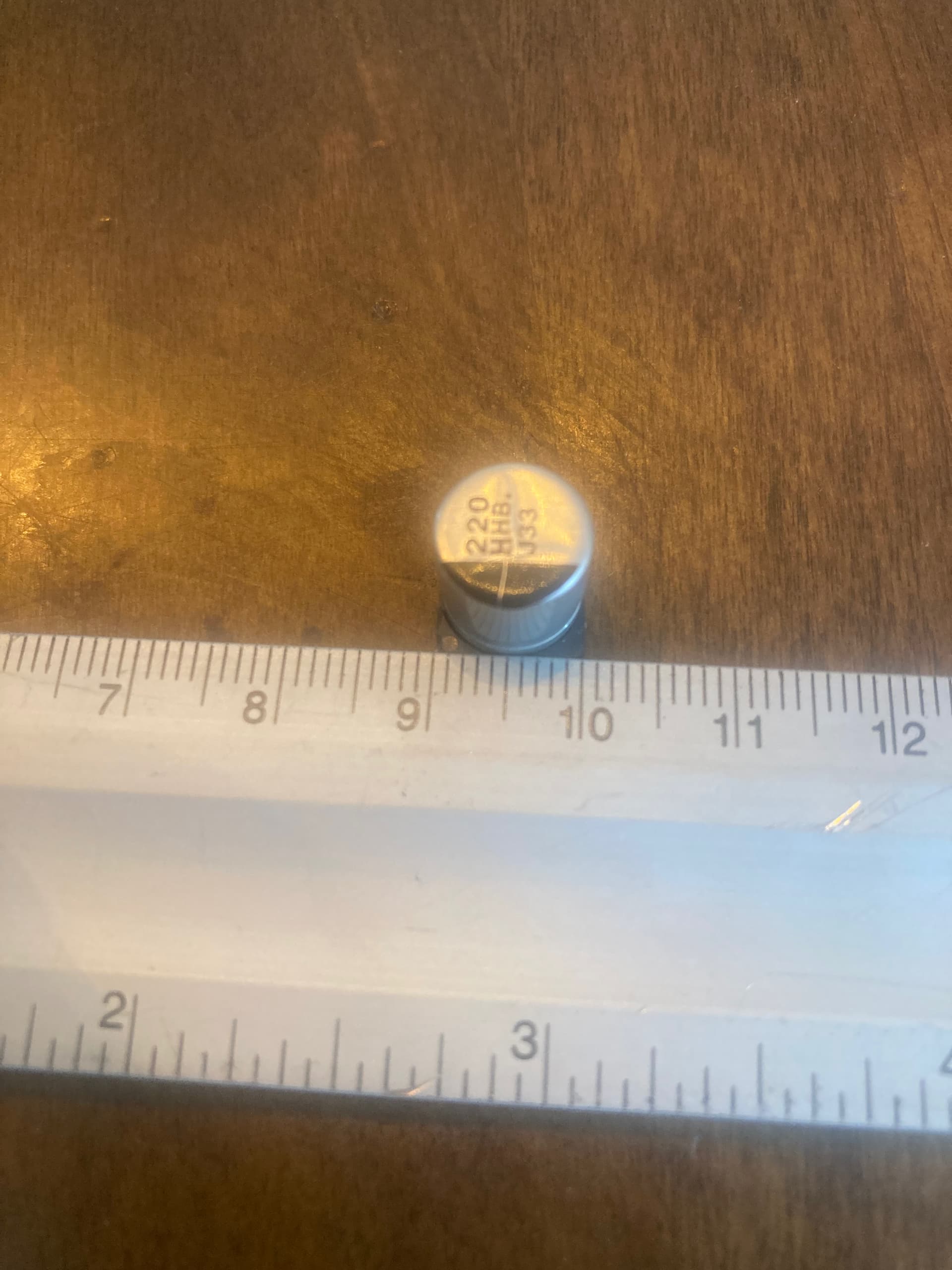

Working on fixing a thermostat I comfort that has a blank screen read many forms and one thing that they said to try was changing out the capacitors. This is the area I know nothing about, but I’m trying to learn and any help would be appreciated. Would you guys be able to guide me in the direction of what capacitors to buy? I have to replace the three of them two are the same but not sure which ones to get

For the 3 would you have dimensions?
Height?
Diameter?

For the items marked with the 220 I found the items in the below links so far.
[Aluminum Electrolytic Capacitors | Electronic Components Distributor DigiKey](https://www.digikey.com/en/products/filter/aluminum-electrolytic-capacitors/58?s=N4IgjCBcpgnAHLKoDGUBmBDANgZwKYA0IA9lANogAMIAugL7EBMVALEtCAA4AuUIAVQB2ASx4B5dAFl8mXAFcATvhDF5-AK0AxVSAC2IofyYtdezAA9jpxiBYB2Dqgw4CxMpEpgqVAAQA1XXg-QOIANgBmAN0AVhDdCJjo5iTA2mJefmExSRk5JRV6WyYKEAVFLBR8Xz0SeSE%2BBiA)
For the item marked 47 / 10v I found the items in the below links so far.
[Surface Mount Aluminum Electrolytic Capacitors | Electronic Components Distributor DigiKey](https://www.digikey.com/en/products/filter/aluminum-electrolytic-capacitors/58?s=N4IgjCBcoGwJxVAYygMwIYBsDOBTANCAPZQDaIALAAxwDMdIAuoQA4AuUIAymwE4CWAOwDmIAL6EwcABwJoIFJAw4CxMiCpMJIAExUKc0O04BVQfzYB5VAFlc6bAFdeuEIUecArQDE3IALZCnBQA7H7%2B6AAewWHaeiGGIMaQIGYW1nYOzq7unABq4UEpYJraALQ6iApQfI6qJJDkAKxaYmJAA)

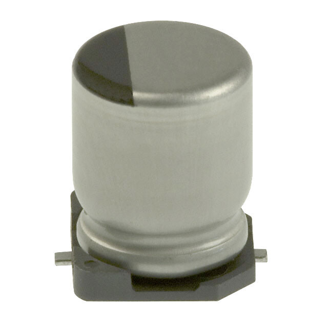

For the larger capacitors it’s looking like you have a Panasonic HB Series 50V 220uF
[EEE-HBH221UAP Panasonic Electronic Components | Capacitors | DigiKey](https://www.digikey.com/en/products/detail/panasonic-electronic-components/EEE-HBH221UAP/1717964)

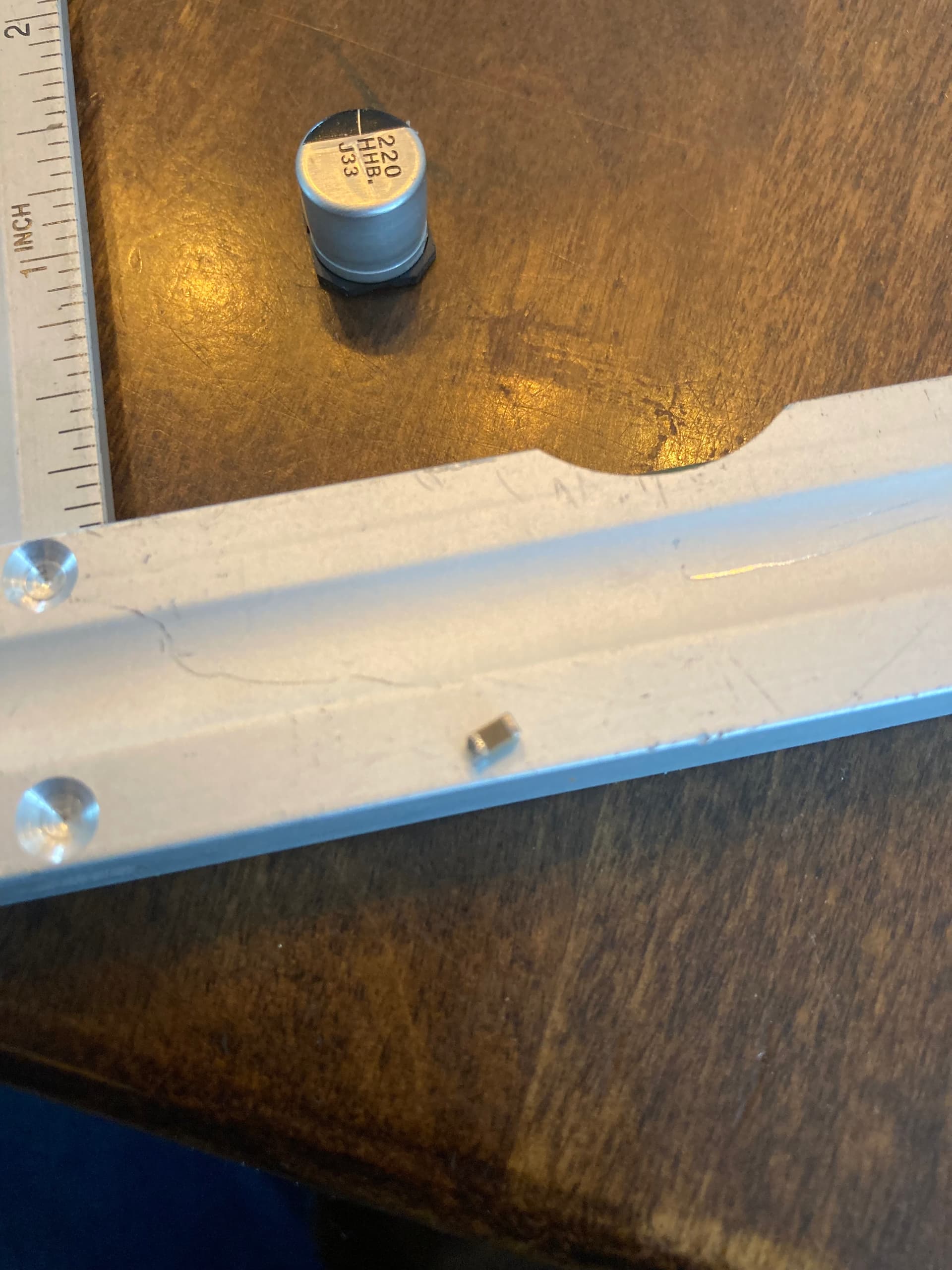

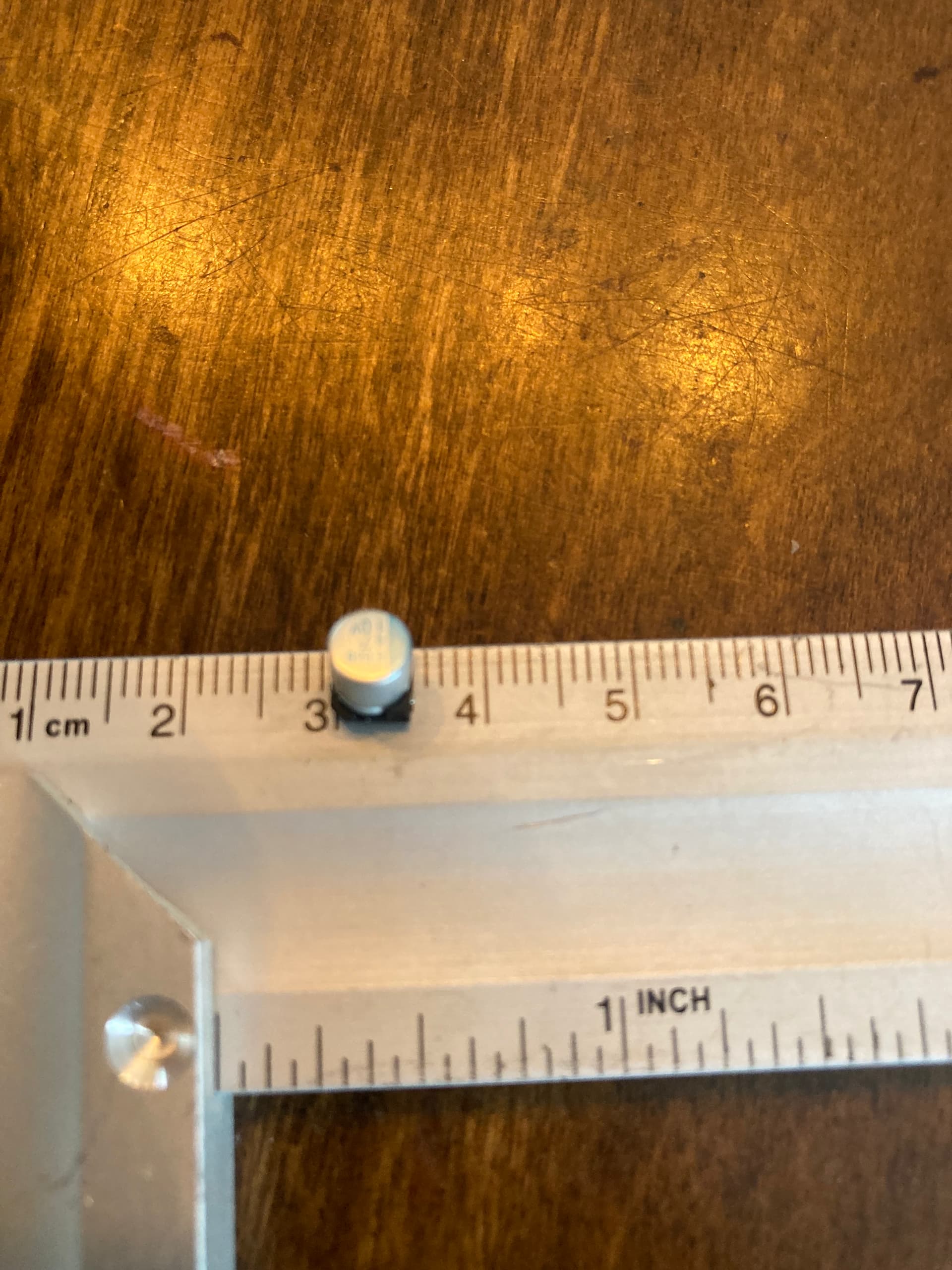

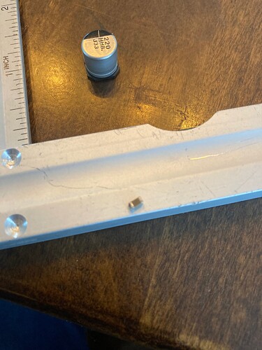

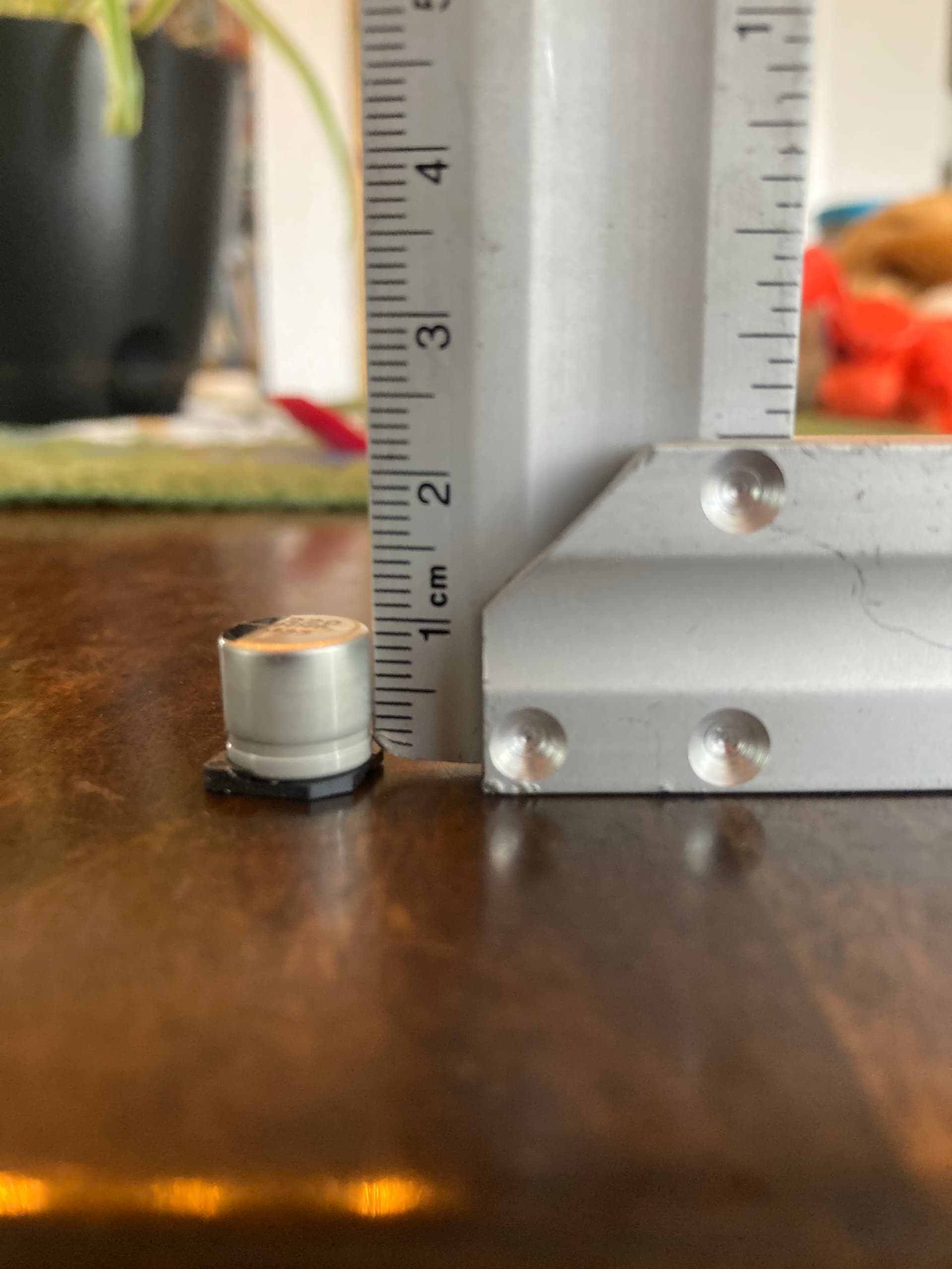

I added some pics for size also one picture has a little pic on the handle do the square that I broke off. Would I be able to re attach that or would I have to get new as well. Appreciate all the feedback so far it has been very helpful

@ernstlcody
The cap @Kristof_2649 gave for the 220µF item would work.
The 565-EMVE250ARA470MF55GCT-ND would look to be a match for the smaller of the 3 for the 47µF
> **[EMVE250ARA470MF55G | DigiKey Electronics](https://www.digikey.com/en/products/detail/chemi-con/EMVE250ARA470MF55G/756865)**
> Order today, ships today. EMVE250ARA470MF55G – 47 µF 25 V Aluminum Electrolytic Capacitors Radial, Can - SMD 1000 Hrs @ 105°C from Chemi-Con. Pricing and Availability on millions of electronic components from Digi-Key Electronics.

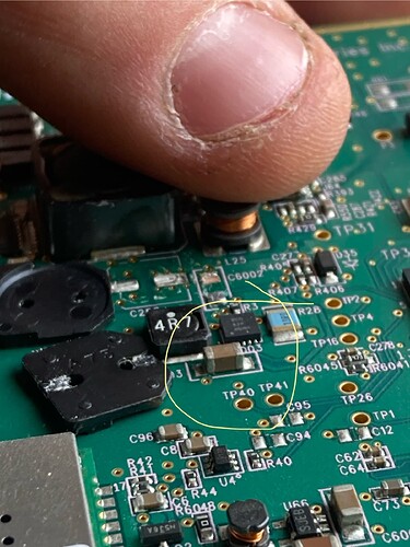

Thank so much for the help I will get those ordered. Last question while removing the capacitor I broke this something off of course. I attached a pic of it would anyone know what it is

@ernstlcody
I am sorry to say that I am not sure what that item would be in your image.

**Author:** ![jeff\_12063](https://avatars.discourse-cdn.com/v4/letter/j/65b543/32.png) [@jeff\_12063](https://forum.digikey.com/u/jeff_12063)\
**Post date:** [June 25, 2025, 7:28pm UTC](https://forum.digikey.com/t/capacitors/56737/11 "2025-06-25T19:28:36Z")
@ernstlcody
I can’t say for sure, but it looks like a fuse or capacitor in a 2410 package size.
