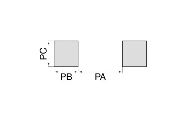

Can you explain what you are meaning by used for Chassis. If this is in regards to mounting this part is intended for surface mounted to PCB this part is standard package case of 1210 (3225 Metric).
 ![image](https://global.discourse-cdn.com/digikey/original/3X/8/a/8a4bab26cf747259e62cba252bedbb9cedf0e8ff.png)
**PCB Land Pattern**
| **Recommended Land Pattern ¶** | 2.00mm to 2.40mm |
| **Recommended Land Pattern (PB)** | 1.00mm to 1.20mm |
| **Recommended Land Pattern (PC)** | 1.90mm to 2.50mm |
