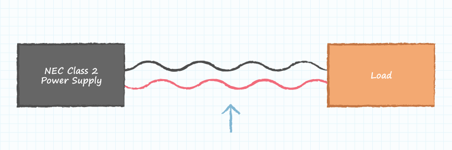

 ![image](https://global.discourse-cdn.com/digikey/original/3X/c/7/c7f5e0e8788ae21396fb360a3ccae5322eeff299.png)
接線受 NEC 2 類電源影響
