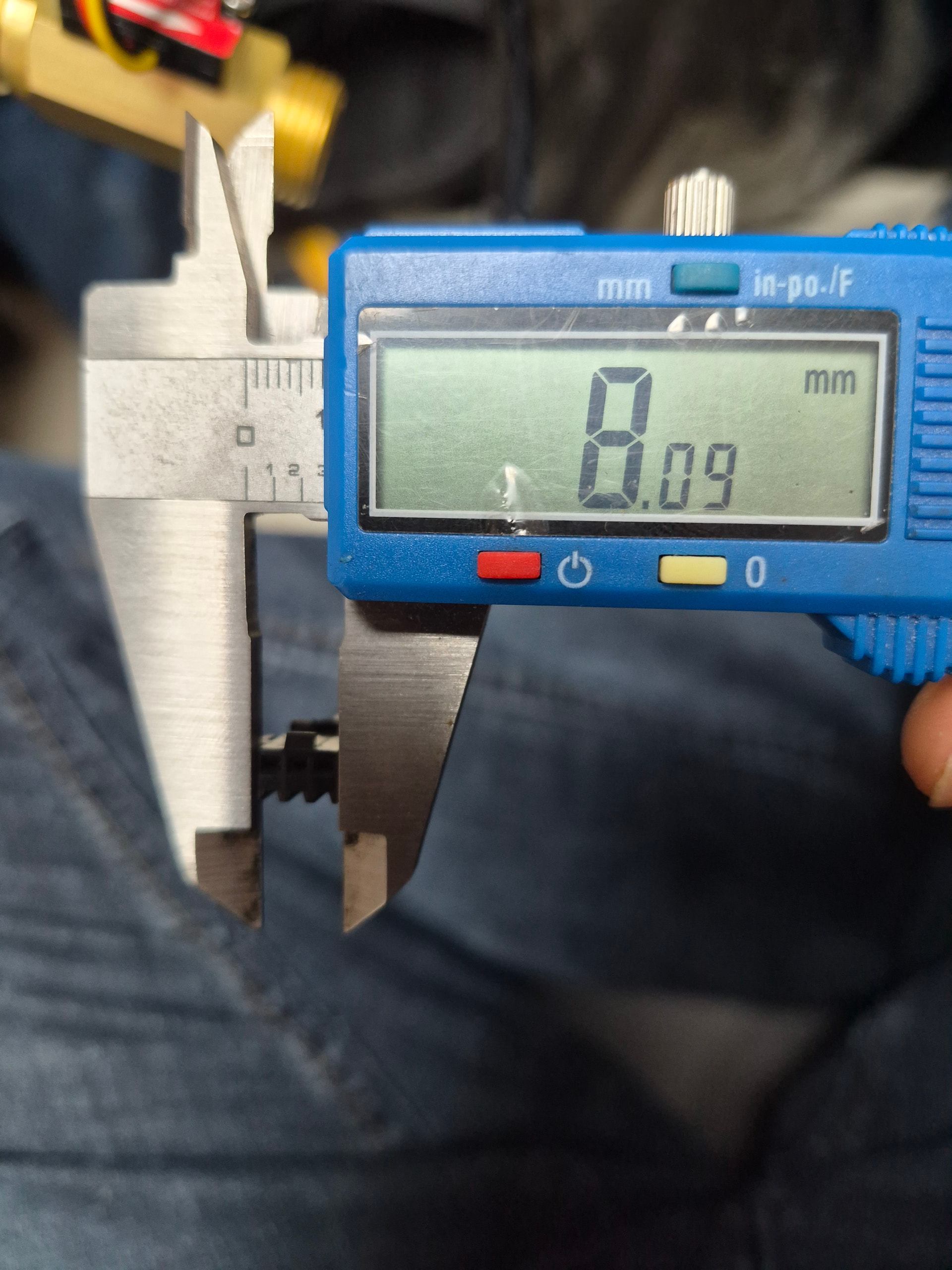

Hi,
sorry for the delay
the center-center pin distance would be 2,5mm
here is 2 pics of the connector
Hello jean-simon.dorval,
Thank you for the pictures. It appears that the connector you have in your hand may be 455-2925-ND. Looking at the datasheet for 455-2925-ND, it does show that the body would be 8mm.
If this is the case, this would mate with 455-2929-ND. This does not come with contacts, so you will also want to look at 455-1909CT-ND.
thank you very much for the help!
Jean-Simon
