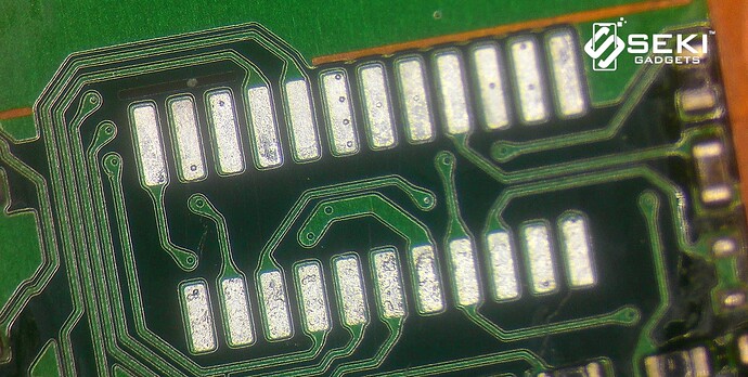

Hello, I’m struggling to find a match for this part on my Fujifilm X-Pro 1 main board. It is labelled CN855 on the plan view image. The macro shots are provided by my local device specialist.
I unfortunately had the bright idea of repairing the device myself, and in the process, destroyed this connection point for a ribbon cable.

Hello marcuscauduro,
Welcome and thanks for posting in the TechForum
I’m not 100% sure with our knowing more about this board, but part number [HFJ124CT-ND](https://www.digikey.com/en/products/detail/hirose-electric-co-ltd/FH12-24S-0-5SH-55/1110322?s=N4IgTCBcDaIGIAkCMYC0YAsBlVAGAdAKxYIAUhhAlCALoC%252BQA) looks to be very similar. Maybe one of our engineers will comment on this as well.
