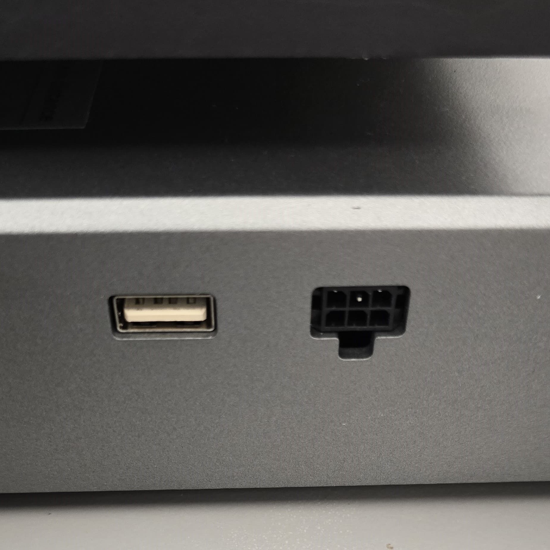

 ![Creality Hi 485 Port](https://global.discourse-cdn.com/digikey/original/3X/c/1/c178abf5cf2ac6439f93bfd599c4b49434ba6837.jpeg)
To connect the CFS to the printer, first make sure the printer is off. Then take the CFS 100cm 485 cable and plug it into the right side of the printer next to the USB A port.

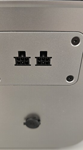

 ![CFS 485 Ports](https://global.discourse-cdn.com/digikey/original/3X/b/2/b2c0bbc0e5489ad994340158489cfcdd4da61e86.jpeg)
 ![CFS Buffer](https://global.discourse-cdn.com/digikey/original/3X/1/1/11f4905f82cedf17f5a132be861d6ded0aede6d5.jpeg)
Connect the other end of the cable to the rear of the CFS unit. Then take the CFS 45cm cable and plug it into remaining port on the CFS and then connector the other end to the CFS buffer.
