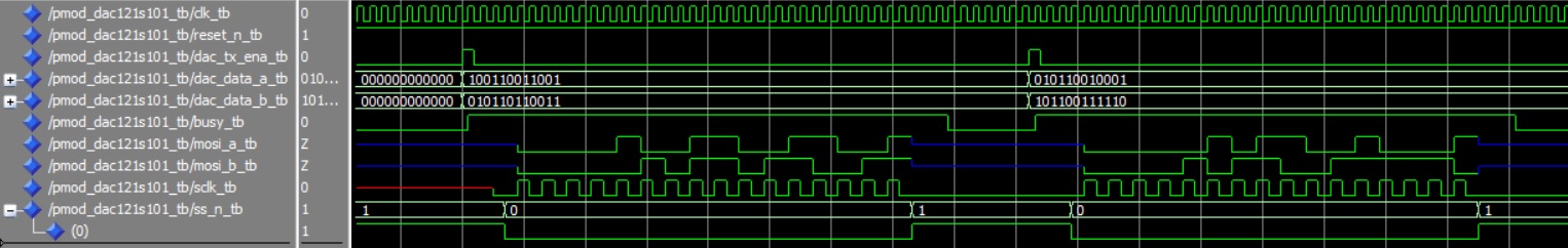

## Example Transaction
Figure 4 illustrates an example transaction. The _busy_ signal is ‘0’. The user logic then presents the data “100110011001” to write to DAC A and “010110110011” to write to DAC B. The Controller asserts the _busy_ signal, indicating the request is latched in, at which point the user logic can deassert the _dac\_tx\_ena_ signal. The Controller sends the serial communication to the DAC Pmod, then deasserts _busy_ when complete. Later, the user logic initiates a new transaction to write “010110010001” to DAC A and “101100111110” to DAC B.
If the _dac\_tx\_ena_ signal is not deasserted, a new transaction request is latched in and begins 20ns after the Controller becomes available.
 ![example_transaction](https://global.discourse-cdn.com/digikey/original/2X/8/8eb22fb6d25b7cc5d88f9dfe26efc5b495ad3bf1.jpeg)
**Figure 4.** Transaction Example
