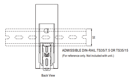

I need a 48V power supply to mount in 19" racks. I see DIN rail mounts available for 19" racks.
Picture of Mean Well EDR-120-48 shows power supply mounted vertically on DIN rail, Can it be rotated 90 degrees so the rack space used is 1RU?
Power supply DigiKey 1866-1442-ND, Description AC/DC DIN RAIL SUPPLY 48V 120W THANK YOU

steven.hughes, welcome to the Forum! You could try rotating this whole part by 90 degrees if you wanted to, but as Irfan said the back mounting unit is fixed. Power supplies like these don’t typically have an “up-right” sensor at all. You would still have to follow the recommended spacing diagram if you did rotate it. I do not see any full rack units that provide DC power. We only have AC power distribution units that fit in a rack. You could cut a din-rail and mount it the other way by rotating the DIN rail vertically, but this isn’t recommended by the manufacturer.

If I understand this right, you want to be able to rotate this power supply on the din rail by 90 degrees. The bracket on the power supply is fixed, no rotation can occur from what is shown on the drawing in the data sheet page 4:
> **[EDR-120-spec.pdf](https://www.meanwellusa.com/upload/pdf/EDR-120/EDR-120-spec.pdf)**
> 164.71 KB
 ![image](https://global.discourse-cdn.com/digikey/original/3X/b/6/b6e9c804892ad23762749f8103f0fb148c10567a.png)
I’m not sure if there is a power supply that is din rail mounted that can.

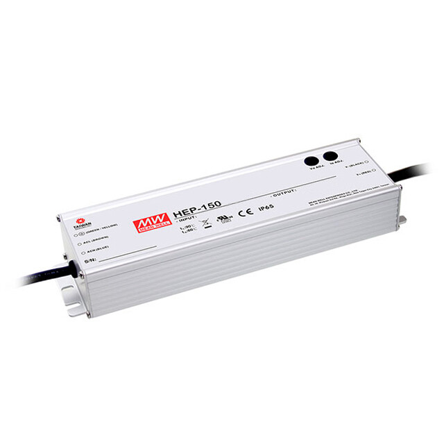

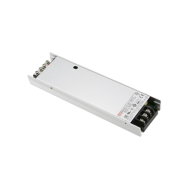

Can you recommend another type that can sit on a shelf as in not DIN rail mounted?
**Author:** ![Kristof\_2649](https://sea2.discourse-cdn.com/digikey/user_avatar/forum.digikey.com/kristof_2649/32/2325_2.png) [@Kristof\_2649](https://forum.digikey.com/u/Kristof_2649)\
**Post date:** [June 24, 2025, 8:42pm UTC](https://forum.digikey.com/t/din-mounting-basics/56732/10 "2025-06-24T20:42:34Z")
Couple options:
 ![image](https://global.discourse-cdn.com/digikey/original/3X/d/4/d45f4672e9f7205376d805644ce50563ed9b0b22.jpeg)
[HEP-150-48A](https://www.digikey.com/en/products/detail/mean-well-usa-inc/HEP-150-48A/7703817)
 ![image](https://global.discourse-cdn.com/digikey/original/3X/1/8/18c8c0c1a8d70743bf1688a84d556fccf130b65e.png)
[LSP-160-48T](https://www.digikey.com/en/products/detail/mean-well-usa-inc/LSP-160-48T/11689254)
**Author:** ![steven.hughes](https://avatars.discourse-cdn.com/v4/letter/s/8baadc/32.png) [@steven.hughes](https://forum.digikey.com/u/steven.hughes)\
**Post date:** [June 24, 2025, 9:18pm UTC](https://forum.digikey.com/t/din-mounting-basics/56732/11 "2025-06-24T21:18:53Z")
Thank you the HEP-150-48A will be perfect, ordering now.
