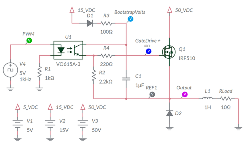

## 2. Bootstrap drive
A bootstrap drive uses a capacitor to store the voltage difference when the low-side MOSFET is on, then uses this voltage to drive the high-side N-MOSFET.
**It is suitable for** half-bridge or full-bridge circuits (e.g., inverters, motor drives) and scenarios requiring elevated Vgs for high-side MOSFETs.
### Advantages
- **Lower Rds(on)** for higher efficiency (uses N-MOSFETs for high-side switching )
- Compact and cost-effective
### Limitations
- Cannot maintain continuous high-side ON time
- Needs **periodic low-side conduction** to recharge bootstrap capacitor
- Limited by PWM duty cycle (sufficient time must be allocated for capacitor charging)
## Design Considerations
- **1. Bootstrap Capacitor Selection (C\_boot)**
Its capacitance should be at least **10 times the high-side MOSFET’s gate capacitance** to ensure sufficient charge during switching. Use multilayer ceramic capacitors ( **MLCC** ) with low equivalent series resistance (ESR) and inductance ( **ESL** ) to reduce voltage ripple and improve reliability.
- **2. Bootstrap Diode Selection**
Choose a Schottky diode with low forward voltage drop and fast recovery to minimize power loss and improve switching speed.
- **3. Bootstrap Resistor (R\_boot)**
Include a bootstrap resistor (R\_boot) to limit peak current during startup, protecting the diode. Balance the resistor value between charging time and current limiting to avoid excessive delay or high inrush current.
- **4. PCB layout**
Place the bootstrap capacitor and diode as close as possible to the driver IC to minimize parasitic inductance and resistance. Reduce loop area for high-current paths to lower EMI and voltage spikes.
- **5. Conduction Time Limitation**
Bootstrap circuits are unsuitable for prolonged high-side MOSFET conduction, as the capacitor may not sustain sufficient voltage. For low-frequency or static applications, consider isolated drive solutions.
## Example Circuit: Bootstrap-Based High-Side Drive
 ![image](https://global.discourse-cdn.com/digikey/original/3X/6/a/6a5d07a6df879366b1ce2258f46db11b07979a35.png)
**Example of MOSFET bootstrap drive circuit**
The example above shows a simplified high-side MOSFET gate drive circuit for brushed or brushless motor H-bridges or three-phase H-bridges.
Bootstrap capacitor C1 supplies energy for gate drive, sourced directly from the optocoupler’s output transistor. The circuit uses a common-collector configuration, with an NPN transistor pulling the MOSFET gate up to the bootstrap voltage. During turn-off, resistor R2 discharges the MOSFET gate through current-limiting resistor R4.
