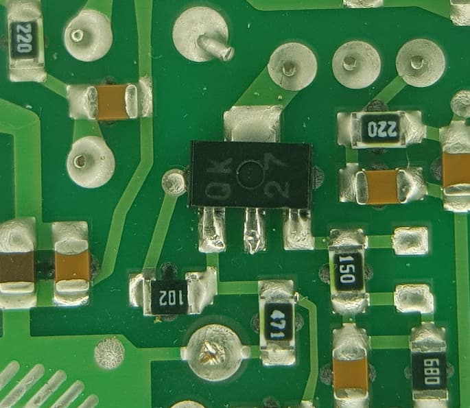

2SC4226 ? 2SC2954 is used for driver in TS50 kenwood transmitter

**Author:** ![dl6lr](https://avatars.discourse-cdn.com/v4/letter/d/57b2e6/32.png) [@dl6lr](https://forum.digikey.com/u/dl6lr)\
**Post date:** [July 3, 2025, 6:58am UTC](https://forum.digikey.com/t/equivalent-2sc2954-sot89/48157/6 "2025-07-03T06:58:02Z")
Sorry for digging up the old thread. I am searching a replacement too, Kenwood transceiver too, it is used for the VCO buffer amplifier at 73..113MHz. What about the BFQ18A? It seems to have similar data, but I couldn’t find a noise figure. I think this is not much important for the high level amp stage here. I would’n mind a different package.
Thanks Bernd
**Post date:** [July 3, 2025, 11:56am UTC](https://forum.digikey.com/t/equivalent-2sc2954-sot89/48157/8 "2025-07-03T11:56:55Z")
Hi APDahlen,
thank you for your fast response. According to my datasheet of the 2SC2954 from NEC it has the same layout. It is confusing as the NEC datasheet shows the transistor from the back (solder) side as ECB (at least this is what I would interpret from the drawing), but NxP shows it from the top as BCE. But I found a datasheet from isc which states BEC. That does not make any sense to me, so I checked the board layout again and the middle pin is the collector and right pin is emitter, so definitely BCE.
And yes, the 2SC2954 has high power, high amplification, high frequency and with 18V a high Uce, so not an easy to replace part.
Thank you for your opinion and the pointer to a different pinout, I will place an order for BFQ18A which is still in stock but an outdated part as well.
Greetings Bernd

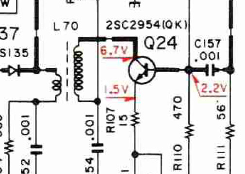

**Post date:** [July 3, 2025, 12:05pm UTC](https://forum.digikey.com/t/equivalent-2sc2954-sot89/48157/9 "2025-07-03T12:05:12Z")
From the service manual:
 ![grafik](https://global.discourse-cdn.com/digikey/original/3X/3/5/35915879921770033600b7a8858a3a3c4aacb632.jpeg)
 ![grafik](https://global.discourse-cdn.com/digikey/original/3X/1/a/1aff4328473aa24e6a52fde6c5a4a1b200d139ea.jpeg)
 ![grafik](https://global.discourse-cdn.com/digikey/original/3X/8/7/871b2f13566ae4bd15b97f136eba1d2a302c01f6.jpeg)
**Author:** ![APDahlen](https://sea2.discourse-cdn.com/digikey/user_avatar/forum.digikey.com/apdahlen/32/40191_2.png) [@APDahlen](https://forum.digikey.com/u/APDahlen)\
**Post date:** [July 3, 2025, 4:42pm UTC](https://forum.digikey.com/t/equivalent-2sc2954-sot89/48157/10 "2025-07-03T16:42:34Z")
Thank you for the correction and pictures, @dl6lr.
Please let us know if you were successful in restoring your transceiver.
