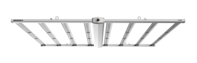

![image](https://global.discourse-cdn.com/digikey/original/3X/d/0/d0f85b2d63a6b1b5943228c3f30739ea22cb8203.jpeg)
So I wanna build something like this. There is 8 bars, each bar is roughly 46inches. I am assuming each bar can attach 2 LED strips. That means this build will required 16 led strips? What driver will i need to build something like this pic i have above. Thanks for the input you guys.

I have recently posted a grow light I want to put together. From the info you provided, so i would need 4x hlg-480 drivers to make a 5x5 coverage.
**Author:** ![rick\_1976](https://sea2.discourse-cdn.com/digikey/user_avatar/forum.digikey.com/rick_1976/32/1571_2.png) [@rick\_1976](https://forum.digikey.com/u/rick_1976)\
**Post date:** [January 26, 2022, 1:33am UTC](https://forum.digikey.com/t/finding-a-compatible-driver-for-the-led-strip-build/19572/8 "2022-01-26T01:33:01Z")
Choose how much light you want; use enough LEDs to get there, and enough drivers to power them.
> [@el\_dooky](#):
> 4x hlg-480 drivers
In context of prior discussion,that would translate into a 1.6kW array; roughly the equivalent of common electric space heaters. Thermal management seems likely to become problematic. Consider starting with half that, leaving provisions for expansion if needed.
**Author:** ![el\_dooky](https://avatars.discourse-cdn.com/v4/letter/e/85e7bf/32.png) [@el\_dooky](https://forum.digikey.com/u/el_dooky)\
**Post date:** [January 26, 2022, 3:06am UTC](https://forum.digikey.com/t/finding-a-compatible-driver-for-the-led-strip-build/19572/9 "2022-01-26T03:06:00Z")
I understand what you’re saying. I’m just trying to replicate these grow LED thats in the market. Are they using a special driver to operate such fixtures because the amount of driver needed to run a 5x5 coverage LED fixture is a lot
**Author:** ![Ryan\_2724](https://sea2.discourse-cdn.com/digikey/user_avatar/forum.digikey.com/ryan_2724/32/1716_2.png) [@Ryan\_2724](https://forum.digikey.com/u/Ryan_2724)\
**Post date:** [January 26, 2022, 3:15pm UTC](https://forum.digikey.com/t/finding-a-compatible-driver-for-the-led-strip-build/19572/10 "2022-01-26T15:15:44Z")
Another option may be [1145-USCO-320210GA-ND](https://www.digikey.com/en/products/detail/delta-electronics/USCO-320210GA/10312991) to power 4 strips wired in series connection.
It could be they use a custom driver specially manufactured for their design. Although initially expensive to create, custom designs save money on a mass production scale.
