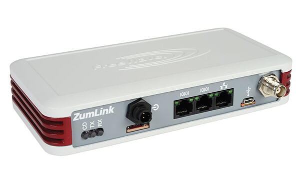

[FreeWave Technologies](https://www.digikey.com/en/supplier-centers/freewave-technologies) offers an array of sensors and equipment for your use, including their [Z9-PE](https://www.digikey.com/en/products/detail/freewave-technologies/Z9-PE/9963081) gateway device. This product doesn’t ship with a power supply, though. Which power supply should you get?
 ![FreeWave gateway Z9-PE](https://global.discourse-cdn.com/digikey/original/3X/8/8/885471143073b9340fe03126cd4e5e1d8978b6ff.jpeg)
[SWI12-12-N-SC](https://www.digikey.com/en/products/detail/cui-inc/SWI12-12-N-SC/5052004) is a good place to start, as this gateway uses Switchcraft’s [17282-2PG-300](https://www.digikey.com/en/products/detail/conxall-switchcraft/17282-2PG-300/526171) as its power connector. The mate for that connector is [16282-2SG-311](https://www.digikey.com/en/products/detail/conxall-switchcraft/16282-2SG-311/526168), which you can wire to the CUI power supply listed above.
