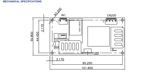

Could you please confirm the exact DC output on the FSP065-P24-A19 board?
Specifically: + 19.0 V, 3.42 A?
Also, could you provide a drawing/photo showing mounting holes and the connector pin layout?
Thanks in advance
Hello @fintan.p.collins
Welcome to Community!
Yes, the FSP065-P24-A19 board provides the following DC output:
  • Voltage: +19.0 V
  • Current: 3.42 A
  • Power: 65 W
And for connector pin and mounting hole details, please refer part datasheet
