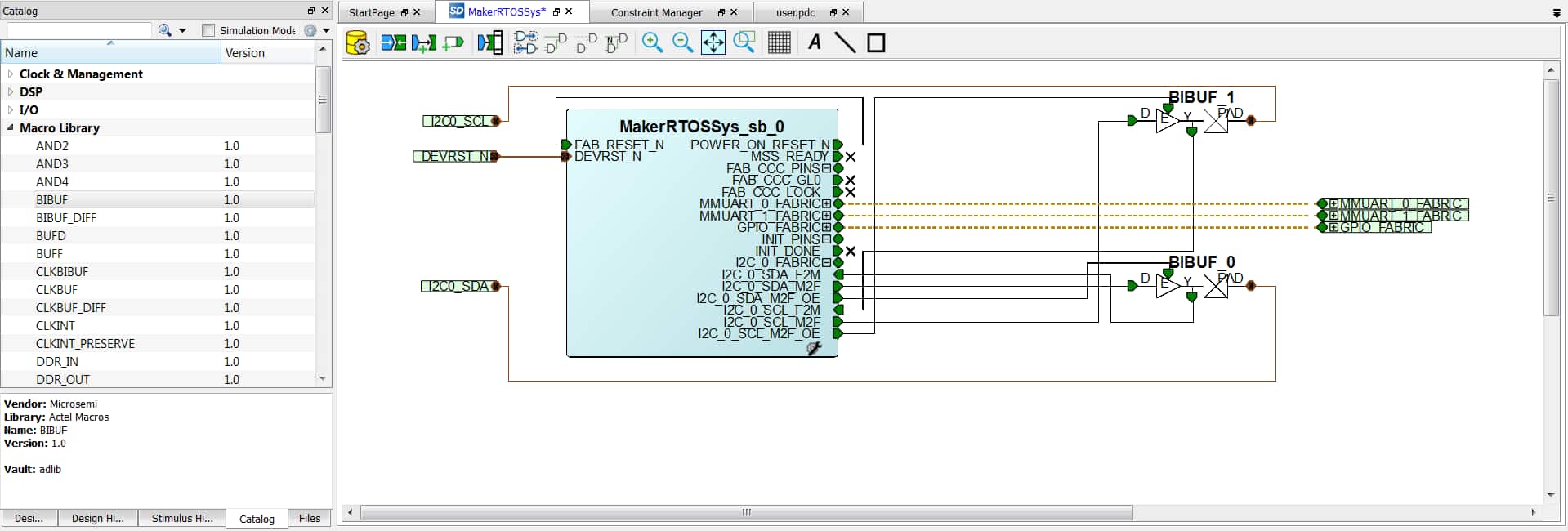

21. Open the IP **Catalog** to the left and expand the **Macro Library**. Drag two instances of the **BIBUF** macro to the design.
22. Select the **MM\_UART0** , **MM\_UART1** , and **GPIO\_FABRIC** interfaces and right-click on them. Choose **Promote to Top Level.**
23. Expand the remaining groups and select **INIT\_DONE, FAB\_CCC\_LOCK, FAB\_CCC\_GL0,** and **MSS\_READY.** Right-click on them and choose **Mark Unused.**
24. Connect the remaining signals as shown in the diagram below.
 ![](https://global.discourse-cdn.com/digikey/original/3X/e/c/ecff7e08fde1edb9a23a995533beab425c64fc51.jpeg)
