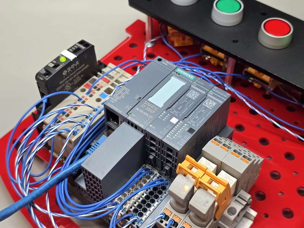

A demonstration Siemens ET 200SP setup is shown in Figure 1. As configured, the modules provide 8 digital inputs and 16 digital outputs. A variety of support hardware is shown in the picture, including an [electronic circuit breaker](https://forum.digikey.com/t/electronic-circuit-breaker-protector-for-industrial-control/55325), [relays](https://forum.digikey.com/t/polarity-and-flyback-protection-in-an-industrial-control-relay/52264), and [pushbuttons](https://forum.digikey.com/t/how-to-locate-part-numbers-for-front-panel-pushbutton-and-switches/37628) all installed on an [industrial breadboard](https://forum.digikey.com/t/powering-the-phase-dock-trainer-a-digikey-lab/44504)
 ![Figure 1: The Siemens Simatic ET 200SP installed on an industrial breadboard with supporting hardware.](https://global.discourse-cdn.com/digikey/original/3X/c/e/ce6b396c7ab3bb4be2776f53d07108596d5b06f8.jpeg)
**Figure 1** : The Siemens Simatic ET 200SP installed on an industrial breadboard with supporting hardware.

- Interface module [6ES7 155-6AU01-0BN0](https://www.digikey.com/en/products/detail/siemens/6ES71556AU010BN0/14636226?s=N4IgTCBcDaIGwFEDKB2AjAVg3AggVQAY0CAhAOQJAF0BfIA) prominently displayed in the middle of Figure 1 with the pastel blue tag and distinctive SIEMENS logo.
- PROFINET adapter [6ES7 193-6AR00-0AA0](https://www.digikey.com/en/products/detail/siemens/6ES71936AR000AA0/14636301?s=N4IgTCBcDaIGwFEDKB2ABARgJwGYC0cAggEoAMpephhpIAugL5A) mounted on the interface module. The RJ-45 connectors can be seen.
- Digital input module (24 VDC with 8 inputs) [6ES7 131-6BF01-0BA0](https://www.digikey.com/en/products/detail/siemens/6ES71316BF010BA0/14636670?s=N4IgTCBcDaIGwFEDKB2ABARgMwYLRwCEAxABjxIIEESQBdAXyA) plugs into the matching [6ES7 193-6BP00-0DA0](https://www.digikey.com/en/products/detail/siemens/6ES71936BP000DA0/14636386?s=N4IgTCBcDaIGwFEDKB2AjATgMwFo4CEAFABmJ2IBEBBYkAXQF8g) base unit.
- Digital output module (24 VDC with 16 outputs) [6ES7 132-6BH01-0BA0](https://www.digikey.com/en/products/detail/siemens/6ES71326BH010BA0/14636720?s=N4IgTCBcDaIGwFEDKB2ABARgMxgLRwCEAJABg1xIIEESQBdAXyA) plugs into the matching [6ES7 193-6BP00-0BA0](https://www.digikey.com/en/products/detail/siemens/6ES71936BP000BA0/14635899?s=N4IgTCBcDaIGwFEDKB2ABARgJwGYC0cAQgAoAMpephAgqSALoC%2BQA) base unit.

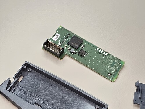

- Server module [6ES7 193-6PA00-OAAO](https://www.digikey.com/en/products/detail/siemens/6ES71936PA000AA0/14635951?s=N4IgTCBcDaIGwFEDKB2ABARgJwGYC0cACgIIAMpepxZaIAugL5A) (VERSION 1.2)
> **Tech Tip** : The server module clips to the far right-hand side of the assembly. It is just visible as a 3/8-inch sliver between the output module and the control relay. We are tempted to view this fuse holder module as an afterthought. However, when we open the unit up we see a relatively complicated circuit as shown in Figure 2.
> **Misconceptions** : This was an important step in my learning as I had previously assumed the server module was a terminating resistor.
 ![Figure 2: Teardown of the Siemens ET 200SP server module.](https://global.discourse-cdn.com/digikey/original/3X/2/0/2008eff189f915443913057a2447df1c2ba4adef.jpeg)
**Figure 2** : Teardown of the Siemens ET 200SP server module.
