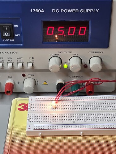

Figure 1: The incandescent lamp is connected directly to the output of the DC power supply.

Work with your lab instructor to construct the incandescent lamp circuit as shown in Figure 1.
Verify that the circuit is operating by observing the lamp’s glow.
Set the power supply to 0.5 VDC.
Record the corresponding current in the table.
Repeat steps 3 and 4 for all voltages in the table as shown in Figure 2.

What did this tell us about Ohm’s Law?
Not all material follows the linear relationship. The incandescent lamp is non-Ohmic.
What is the significance of the straight line?
The Line is Ohm’s Law in action.
It demonstrates that the resistor has a linear relationship between current and voltage. Contrast this with the lamp which has a resistance that varies between 13 Ω to 41 Ω over the range of the experiment.
Describe the current voltage relationship for both the resistor and the bulb.
The resistor has a linear relationship between current and voltage as predicted by Ohm’s Law. The incandescent lamp has a nonlinear response with resistance increasing as a function of applied voltage. The cold resistance is about 13 Ω while the white-hot resistance is about 41 Ω.
Why was the resistor chosen?
The resistor was chosen to match the incandescent lamp’s white-hot resistance. At full rated voltage, the resistor’s current matches the lamp’s current.
In later lessons you will learn about power. In this case, the larger 1 W resistor is required to dissipate the nominal 0.6 W when operating at 5 VDC. Stated another way, the 7268 is a 0.6 W lamp, we a need resistor capable of dissipating the same power.
