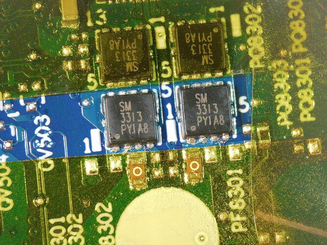

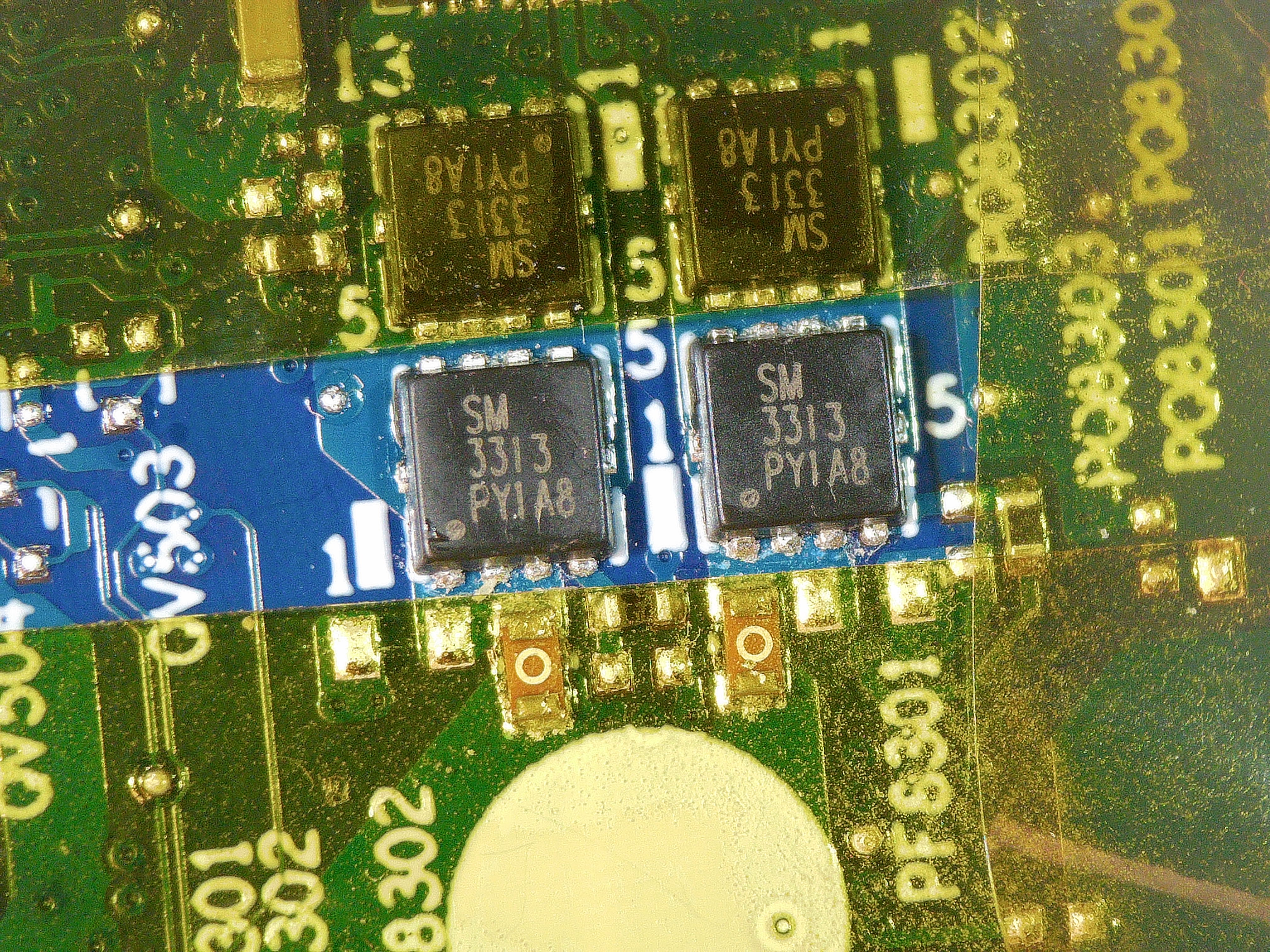

Hello. I have a SM 3313 PY1A8 8 pin mosfet that from a Levono motherboard. Can you tell me if you have this exact mosfet or a crossover for it? Thanks!
Hello, bogart219.
Take a photo of the mosfet.
Show the top and bottom.
Hello bogart219,
The original part number beginning with SM3313 comes up as a Nch Mosfet 30V 46A DFN 3x3mm package.
Alternative part number I have located:
Part number 296-45025-1-ND
Datasheet link for your review https://www.ti.com/general/docs/suppproductinfo.tsp?distId=10&gotoUrl=https%3A%2F%2Fwww.ti.com%2Flit%2Fgpn%2Fcsd17581q3a
Hey Troy, here is a pic of that mosfet that Adam requested a few minutes before you. Thank You for the info!!!
