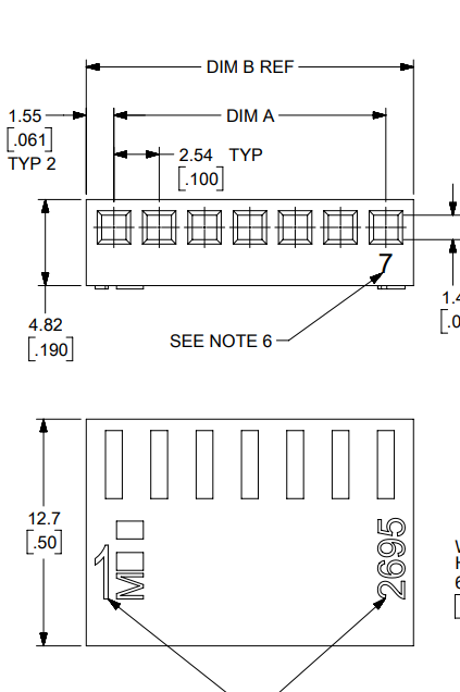

Please help identify the pin/position numbers on the following Molex Housing:
39-01-3022 & 22-01-3047.
For part 0039013022 the datasheet does not show a callout for the pin 1 position. You could use the top to bottom for the wiring. The latch side is on the top calling pin 1 position and then pin 2 is below.
Drawing for 0039013022.

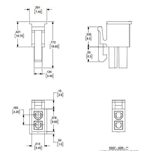

For 0022013047 the datasheet call out the pin positions.
Drawing for 0022013047.
If you are replacing the connectors the designer should have followed the marked pin positions.
