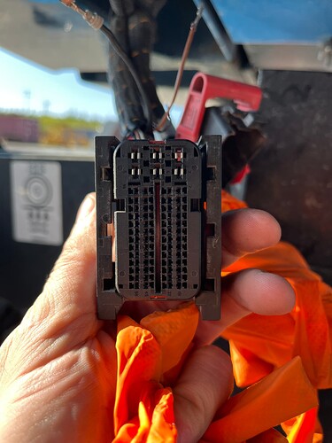

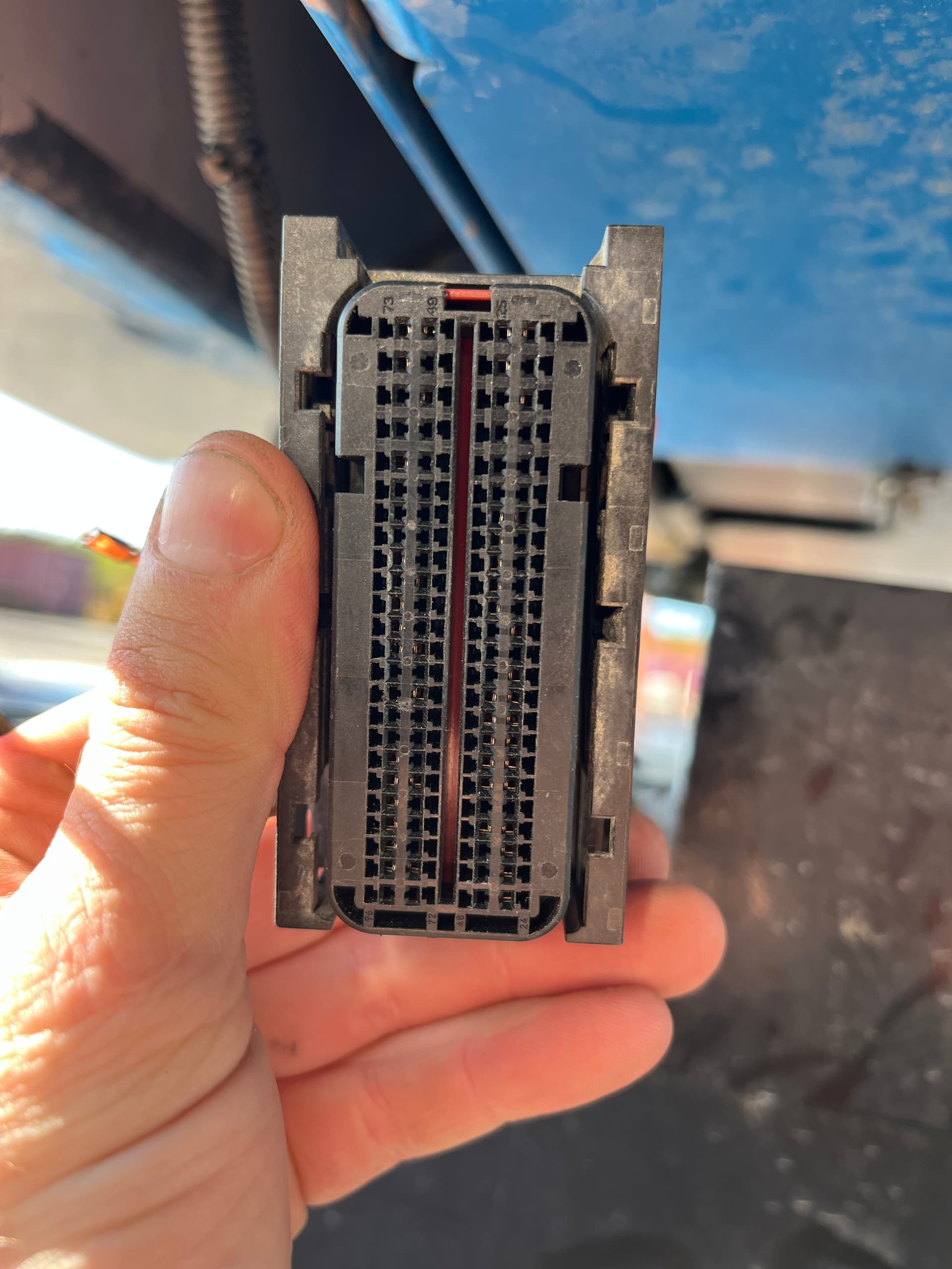

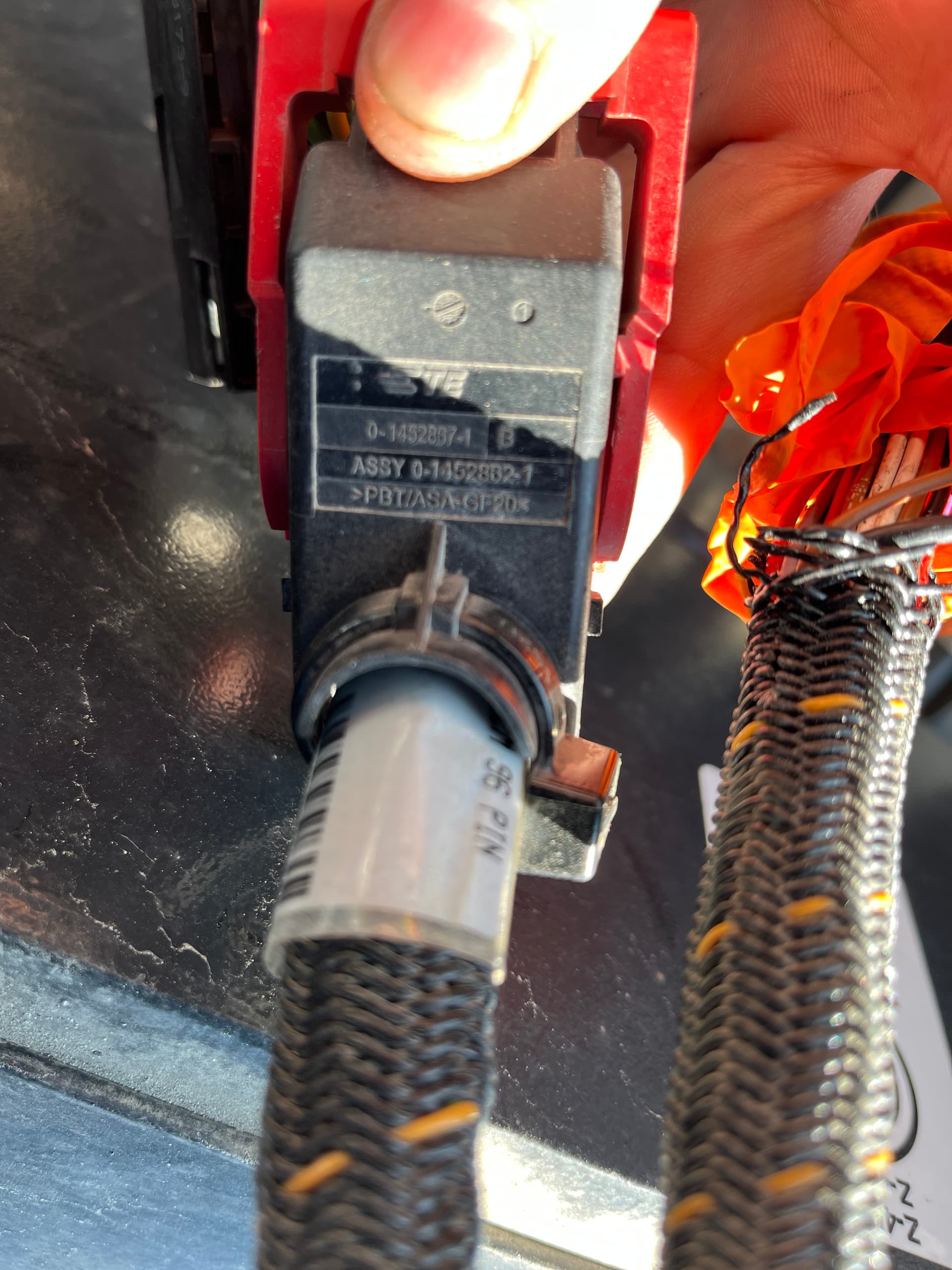

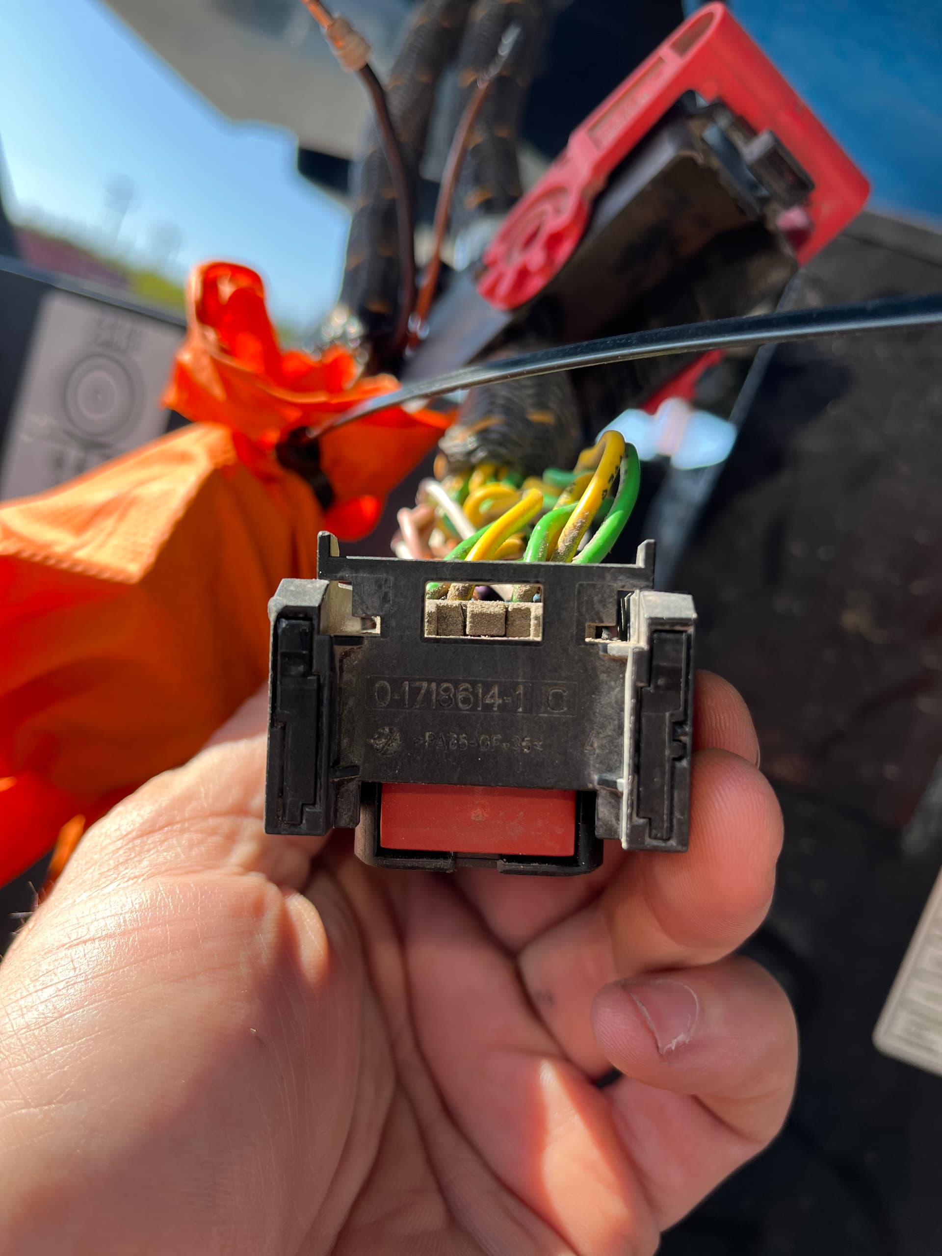

Good day everyone,
i’m looking for some specific connector and I’m not really sure which one I should order.
I need the plastic housing, the flip lock, terminal (both size), tool to remove the terminal from the housing and the right crimping tool to replace the terminal.
I joined some picture of both connector I need to replace for reference.
I found on your site:
# A129159-ND (which should be the big connector)
# 17-1452862-1-ND (which should be the lock for big connector)
# A129158-ND (wich should be the small connector)
# 17-1452416-1-ND (which should be the lock for small connector)
I was not sure on terminal number…
I guess both connector use the same terminal except for the bigger wire in the small connector. (but I need both size)
And tooling.
Thank you.
(i can only put 3 photo so…)
 ![big connector](https://global.discourse-cdn.com/digikey/original/3X/4/3/43d9c294bbf8b8dc260c4e19be8b73238067f231.jpeg)
 ![small connnector2](https://global.discourse-cdn.com/digikey/original/3X/9/f/9f22430c8ff1ea2bb30c992167307dbe5b30509f.jpeg)

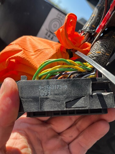

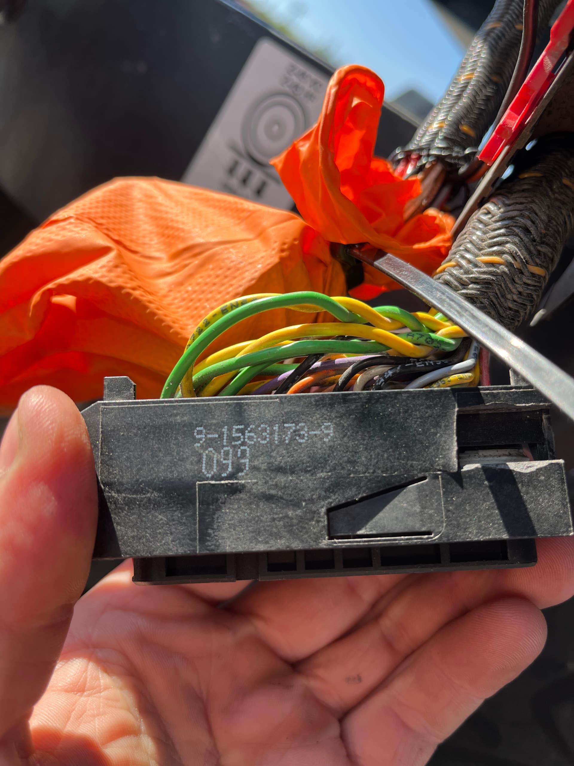

**Author:** ![frbergeron](https://avatars.discourse-cdn.com/v4/letter/f/96bed5/32.png) [@frbergeron](https://forum.digikey.com/u/frbergeron)\
**Post date:** [June 25, 2025, 4:24pm UTC](https://forum.digikey.com/t/identification/56773/2 "2025-06-25T16:24:41Z")
![big connector1](https://global.discourse-cdn.com/digikey/original/3X/a/f/af20d3e48c3af5988b664871af3100640a29c476.jpeg)
 ![big connector2](https://global.discourse-cdn.com/digikey/original/3X/6/e/6e693407028e2bace35961b29a02bb0fb115d63e.jpeg)
 ![big connector3](https://global.discourse-cdn.com/digikey/original/3X/5/7/57b387f089fdb43263603dd11183ddae890dcfcc.jpeg)

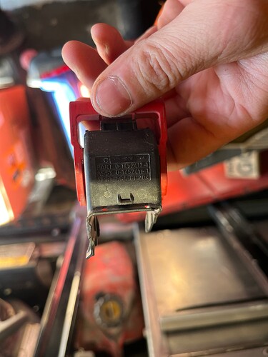

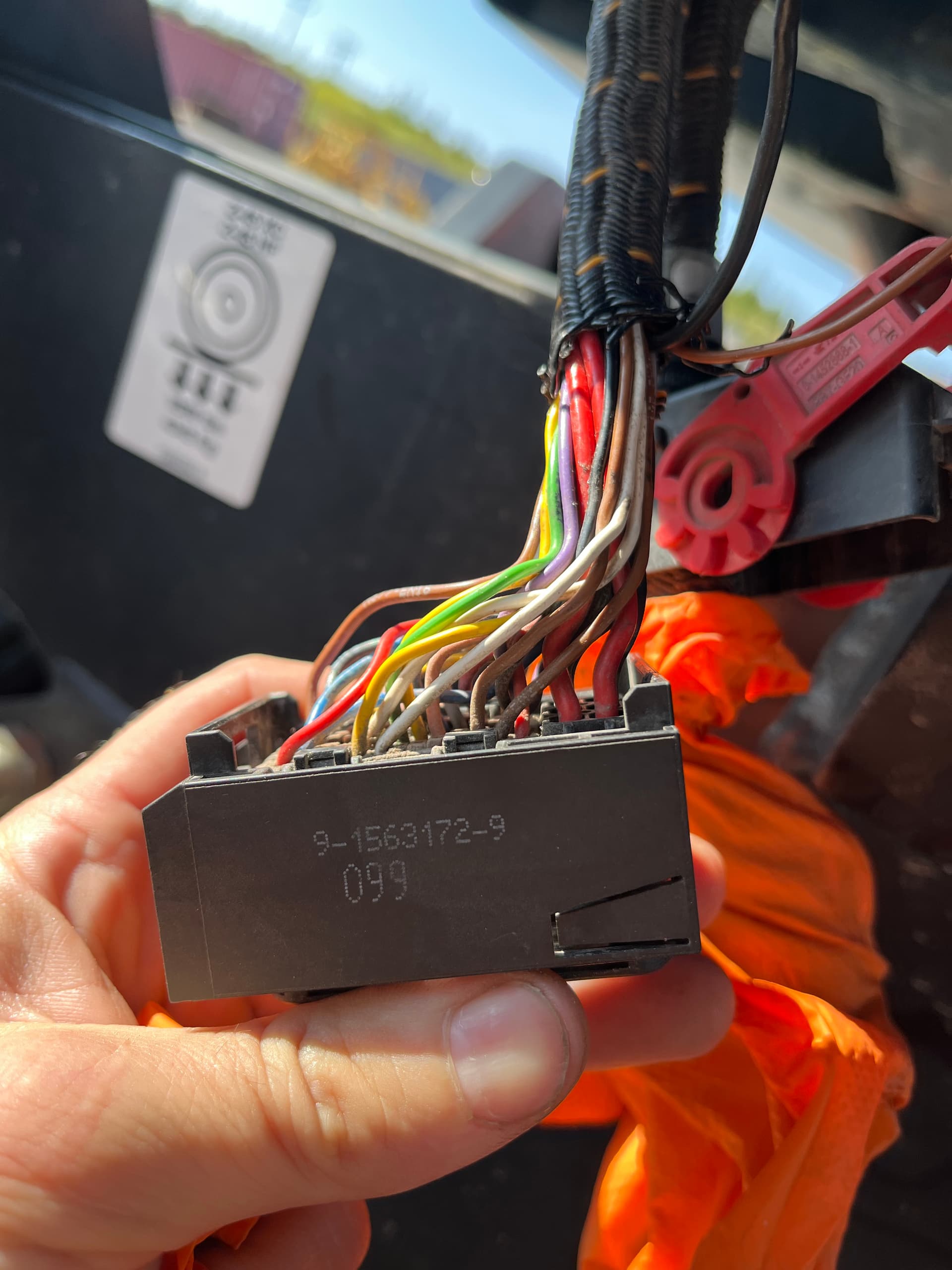

**Post date:** [June 25, 2025, 4:25pm UTC](https://forum.digikey.com/t/identification/56773/3 "2025-06-25T16:25:54Z")
![small connector](https://global.discourse-cdn.com/digikey/original/3X/f/8/f8c7fcac80e8ba0c65c267bbf49ca23d23435bbb.jpeg)
 ![small connector1](https://global.discourse-cdn.com/digikey/original/3X/6/9/695150fc1e15813f3119c12d0812c16c828f1f99.jpeg)
**Author:** ![Nathan\_Henneman](https://avatars.discourse-cdn.com/v4/letter/n/838e76/32.png) [@Nathan\_Henneman](https://forum.digikey.com/u/Nathan_Henneman)\
**Post date:** [June 25, 2025, 4:43pm UTC](https://forum.digikey.com/t/identification/56773/4 "2025-06-25T16:43:08Z")
> [@frbergeron](#):
> [A129159-ND](https://www.digikey.com/en/products/detail/te-connectivity-amp-connectors/9-1563173-9/5437345)
Thank you for contacting DigiKey Technical Support.
These are the contact and tooling options I was able to find.
Contact options
> **[MCON Receptacle and Tab](https://www.te.com/en/product-CAT-M4595-T273.html?r=2&compatible=9-1563173-9)**
> TE's MCON is an automotive series of contact systems commonly used for electrical and electronic applications for passenger cars and commercial vehicles.
Tooling part numbers
> **[2305570-1 : AMP Hand Crimping Tools](https://www.te.com/en/product-2305570-1.html)**
> Get 2305570-1 AMP Hand Crimping Tools specs, pricing, inventory availability, and more from TE Connectivity. Get a sample or request a quote.
**Author:** ![David\_1768](https://sea2.discourse-cdn.com/digikey/user_avatar/forum.digikey.com/david_1768/32/9762_2.png) [@David\_1768](https://forum.digikey.com/u/David_1768)\
**Post date:** [June 25, 2025, 4:58pm UTC](https://forum.digikey.com/t/identification/56773/5 "2025-06-25T16:58:46Z")
Hello frbergeron,
[Click Here](https://www.digikey.com/en/products/filter/rectangular-connector-contacts/331?s=N4IgjCBcoMwAxVAYygMwIYBsDOBTANCAPZQDaIALGAEzUwDsIhFc1AHDBALqEAOALlBABlfgCcAlgDsA5iAC%2Bhem0QgUkDDgLEyIAJwU9cGE3BhDYBDxAChoybIWE6J6GrRY8hEpHIsKAGz0AKwg1raQIuLScvKKINS6YAC0egFsbKFc8kA) for the contacts for the A129158-ND Connector.
The Extraction tool is listed as part number [A121396-ND](https://www.digikey.com/en/products/detail/te-application-tooling/1579007-1/1990881)
