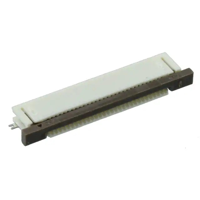

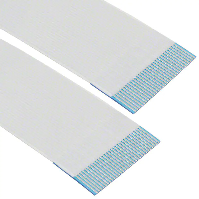

One possible solution, depending on some of the factors above, might be to use Flat Flex ribbon cables and connectors such as these:
30-conductor 0.5mm pitch Flat Flex cables: https://www.digikey.com/short/z24r4v
30-conductor 0.5mm pitch Flat Flex connectors: https://www.digikey.com/short/z24rwj
