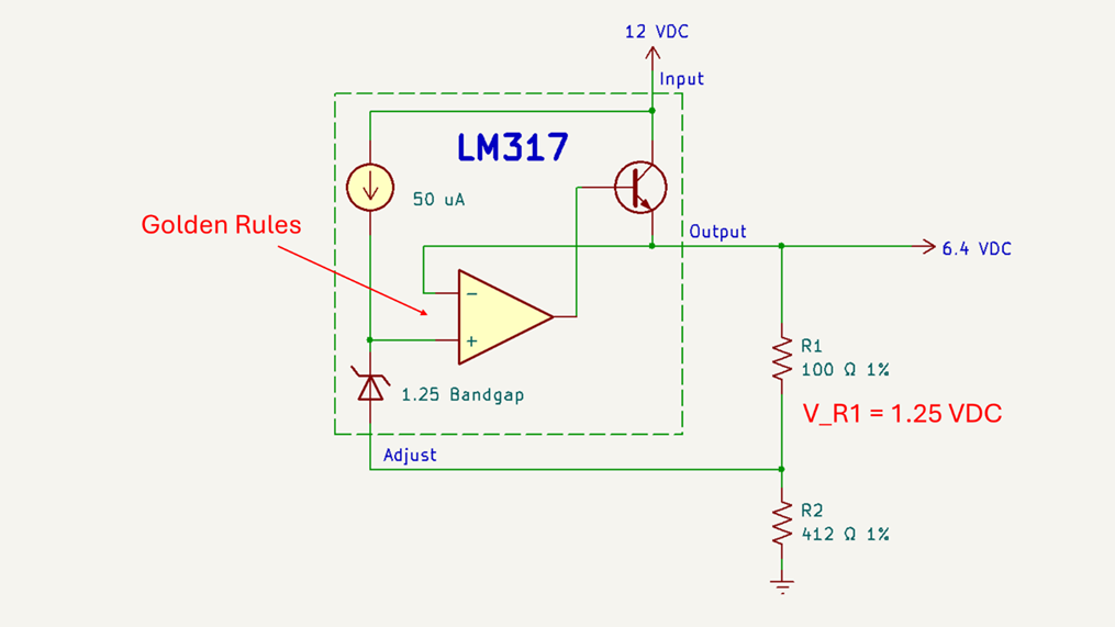

Figure 2 presents the essential LM317 sections. It includes critical internal components and two external components:
- **Voltage Reference** : The LM317 operates using a negative feedback loop where the output voltage is compared to the voltage reference. Stability depends on the quality of the internal 1.25 VDC bandgap reference.
- **Constant current source** : The stability of the voltage reference is further improved by using a constant current source. This acts as an electronic shield, isolating the voltage reference from changes in input voltage.
- **Amplifier** : An amplifier compares the output voltage to the voltage reference.
- **Pass transistor** : The NPN pass transistor as controlled by the op-amp determines the output voltage of the LM317 regulator. The pass transistor is a large device that dissipates power estimated using the equation: P\_{Dissipation} = I\_{Out}(V\_{In} - V\_{Out}).
- **Resistor R1 and R2** : The external resistors are used to determine the output voltage of the LM317.

## Theory of Operation
The bottom line is that the voltage, as measured across R1, is maintained at 1.25 VDC.
### Golden Rules for an Op-amp
To understand the LM317’s operation, we first consider the golden rules for op-amp operation as described by Horowitz and Hill in their famous Art of Electronics book:
- **Rule 1** : The output will do whatever is necessary to make the difference between the inputs zero.
- **Rule 2** : The inputs draw no current.
If we apply these rules to the simplified Figure 2 schematic, we conclude that the voltage across R1 is the same as the voltage reference (1.25 VDC). **This R1 = 1.25 VDC is key to the operation of the LM317.**
### How the LM317 Senses Output Voltage
The output voltage of the LM317 is not ground referenced. Instead, it is implicitly measured as the voltage drop across R1.
Recognize that feedback keeps the R1 voltage constant at 1.25 VDC. A constant voltage across a fixed R1 resistor results in a fixed current. Finally, we intuit that R2’s current is also constant (disregarding the relatively insignificant current flowing in the LM317’s adjust terminal).
## Derivation of the Output Voltage Equation
Essential facts from Figure 2:
- The op-amp maintains R1 voltage equal to the reference voltage (1.25 VDC)
- The op-amp input draws no current.
- The current leaving the LM317’s adjust terminal is insignificant relative to the current passing through R1 and R2. Consequently, the R1 and R2 currents are equal.
- A current of approximately 5 mA is required to maintain the NPN transistor in its linear (active) state.
Knowing that I\_R1 = I\_R2:
I\_{R1} = \frac{V\_{REF}}{R\_1}
I\_{R2} = I\_{R1} = \frac{V\_{REF}}{R\_1}
V\_{OUT} = I\_{R1}(R\_1 + R\_2) = \frac{V\_{REF}}{R\_1}(R\_1 + R\_2) = V\_{REF}\!\left(1 + \frac{R\_2}{R\_1}\right)
