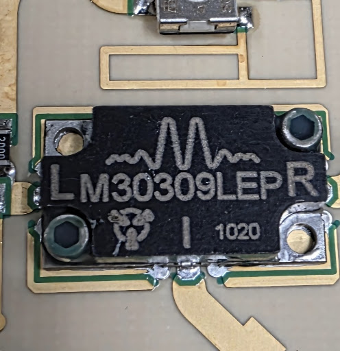

Looking for this part and a spec sheet for it. Does anyone have any idea what it is?
 ![unnamed](https://global.discourse-cdn.com/digikey/original/3X/7/8/78bc958b05a4d3f577fcaf24fe69a82cf832e32e.jpeg)

Hello james\_goos and welcome to the DigiKey TechForum.
It appears that it may be an RF MOSFET from Ampleon. Unfortunately, I have not been able to find any information based on the marking shown.

Based on a Google search, the logo looks very much like the [Marki Microwave](https://markimicrowave.com/) logo.
 ![image](https://global.discourse-cdn.com/digikey/original/3X/0/2/02ac8deffb6e82e24c4054e357713c7aa014efd0.png)
I have not yet identified the particular product.

Thanks I have submitted a request to them to see if it is something that they manufactured.

It is something that they manufactured but the part is no longer available. I need an alternative to put in its place. Attached is the spec sheet for it I just need it in that package or a way to make it fit. Suggestions?
[M3-0309.pdf](https://forum.digikey.com/uploads/short-url/5Ga2Ym3PZD9CoVJnWWHHh7kzeH6.pdf) (158.7 KB)

Hi James,
It doesn’t look good. I don’t see any similar packages, and for such products, layout is often critical to getting reasonable performance, so hacking a different package into a circuit is not likely to give good results.
In any case, just based on a first scan of the specs, [here’s a link](https://www.digikey.com/short/23dnd2rm) to mixers that are at least in the general ballpark.
