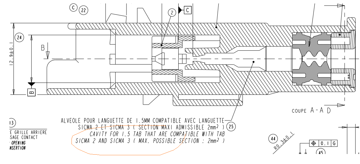

Hello. Could you please tell me the manufacturer and part number of the male terminal used for this product?

Based on the wire gauge size, the following TE Connectivity terminal part numbers are recommended:
1564724-1 — for wire size 0.5 mm²
1670326-1 — for wire size 0.75 – 1.0 mm²
For more details, please refer to the TE document
CONNECTIQUE 2 ET 3 VOIES HP ET HPSL 2 AND 3 WAYS HP AND HPSL CONNECTOR
Thanks.

However, the terminal you introduced is a female terminal.
I would like to know the part number of the 0.5sq wire size male terminal for 1801177-1.
It’s probably not made by TE but by another manufacturer.

Based on the datasheet, the male terminal (Tab) is already included. To complete the connection, the terminal on the opposite side is still required.
Hi, Kevin.
Thank you. I’ll check it.
