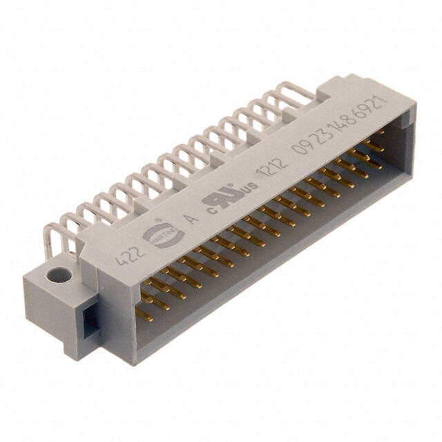

I want to test the operation of the touch sensor through the intercapacitance change that I made with MSP430FR2676 board and CAPTIVATE-PGMR. It’s an 8X8 array and I have a normal wire connected to each line, so what wire should I use to connect it to the MSP430FR2676 board?
If you’re talking about using the CAPTIVATE-FR2676 board the circuit board mounted female header is made to mate with another circuit board mounted male header, something like part number 09231486921
The more connectors and wire that is included with that development board the more capacitance and noise that is potentially introduced into a sensitive system but I don’t know how you’d connect to that development board outside of the above connector.
