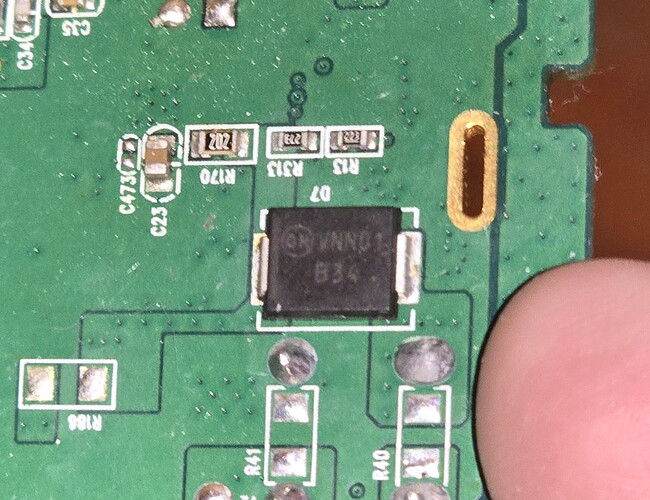

Hi! I’m relatively new to the board, but I’ve got an audio interface giving me issues. Long story short, I think it’s this component or another SMD around power delivery giving me issues, I’m gonna order a few to switch for safe keeping, but I can’t identify this one. Anybody have any ideas what it could be?
 ![20250318_120107](https://global.discourse-cdn.com/digikey/original/3X/7/f/7fec2d8068dba46aa5f0aeea117b853d869f0bb5.jpeg)
The identifying code reads VNN01 B34. I’ve looked around but I can’t figure out just what this is.

Thank you for your inquiry.
I’m sorry, but I was not able to verify what that chip is based on those markings.

Understood, any advice on identifying its function/a suitable replacement?

It’s extremely likely your part is going to be [MBRS340T3G](https://www.digikey.com/en/products/detail/onsemi/MBRS340T3G/918645) made by [onsemi](https://www.digikey.com/en/supplier-centers/onsemi)
We have them in stock.
