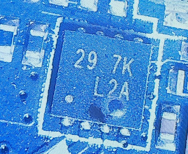

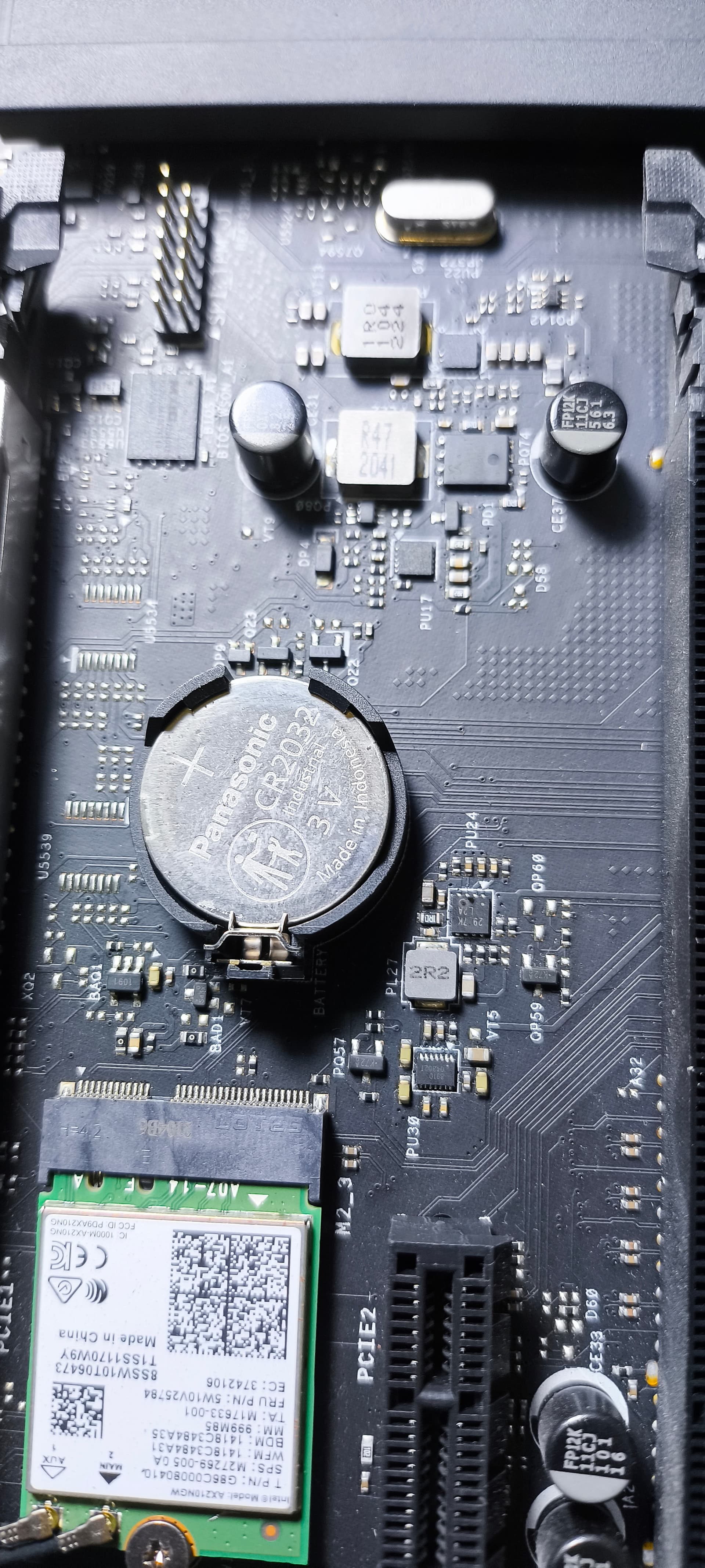

Motherboard NZXT N7 B550
PU24
The “L2A” marking aligns with known Anpec regulators like the APL3512AB.
Hi, thanks a lot! I couldn’t find the IC on any marketplace. Can you help me find an equivalent?
I think the answer is not correct and the datasheet confirms this.
Hi Adam7, could you please help me find the IC..
Wow, thank you so much sir, I think product code is 29. ![]()
You are Welcome! ![]()
Hello @donaernandoelia
The link below will take you to RT8065ZQW that @Adam7 had identified
RT8065ZQW Richtek USA Inc. | Integrated Circuits (ICs) | DigiKey
