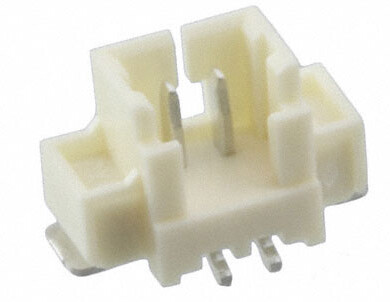

The connector in the forefront from a Mintron Camera has an outside of 2mm \* 4mm and is two pin.
 ![mintro](https://global.discourse-cdn.com/digikey/original/3X/b/b/bbe07172004bb38f97e5ab2553e5b64db825048b.jpeg)
The connector near the NTSC sticker is two pinned and 3.40mm \* 4.20mm.
I figured one was a UART connection but am clueless so far.
Does your company have connectors of this size and shape that are each two pin types?
Seth

Thank you for contacting DigiKey , I have looked through our connector selection and I am not finding these connectors . Is there any markings on the headers that may help us identify them ? What is the pitch of the contacts center to center ?

3.40mm \* 4.20mm = 2mm pins
2mm \* 4mm = 1mm pins
For the above dimensions, those are outside dimensions for the square type connectors.

Hi [silver2row](https://forum.digikey.com/u/silver2row),
Here’s one of them:
[10114828-10102LF](https://www.digikey.com/en/products/detail/amphenol-cs-fci/10114828-10102LF/2658926) Amphenol (FCI) Minitek series 1.25mm pitch header
 ![image](https://global.discourse-cdn.com/digikey/original/3X/4/0/407c3f1835e71d3ea3b1950e2974658b8712158d.png)
Though less certain about the other one, it looks quite a bit like this guy:
[BM02B-SRSS-TB](https://www.digikey.com/en/products/detail/jst-sales-america-inc/BM02B-SRSS-TB/926694) JST SH/SR series 1.00mm header

Hello @silver2row
The mating housing and contacts for part number [10114828-10102LF](https://www.digikey.com/en/products/detail/amphenol-cs-fci/10114828-10102LF/2658926?s=N4IgTCBcDaIIwAY5wCwA4xoLSMWAMgGIgC6AvkA) are;
[10114826-00002LF](https://www.digikey.com/en/products/detail/amphenol-icc-fci/10114826-00002LF/2658910) the housing
[10114827-001LF](https://www.digikey.com/en/products/detail/amphenol-icc-fci/10114827-001LF/2658928) the contacts.
The mating housing and contacts for part number [BM02B-SRSS-TB](https://www.digikey.com/en/products/detail/jst-sales-america-inc/BM02B-SRSS-TB/926694?_gl=1*709j2o*_gcl_au*Nzg0Nzc3NTk0LjE3MTQ2NjE2Mzg.&_ga=2.15388849.641735523.1721653589-1684214985.1714661634) are;
[SHR-02V-S](https://www.digikey.com/en/products/detail/jst-sales-america-inc/SHR-02V-S/759881) the housing
[SSH-003T-P0.2](https://www.digikey.com/en/products/detail/jst-sales-america-inc/SSH-003T-P0-2/700389) the contact

Yes, if you scroll down the page on the links I gave you, the mating connectors are listed. From the mating connector listed, there will be links to the contacts required for them. You’ll note that the crimpers designed for these contacts are seriously pricey.
If possible, I’d recommend using the pre-assembled housings with wires attached. That will save you time and $$$.
Oh, and for the first connector, it looks like Molex makes what _appears_ to be a compatible part in the Picoblade 1.25mm [0533980271](https://www.digikey.com/en/products/detail/molex/0533980271/699066).
![image](https://global.discourse-cdn.com/digikey/original/3X/5/d/5dbc7c7605531b2cbda97fa1f215d6dcefd1bd74.jpeg)
The advantage for this one is that we do have some pre-assembled cable assemblies with the mating connector already attached. Specifically, part number [0151340205](https://www.digikey.com/en/products/detail/molex/0151340205/6198198).
