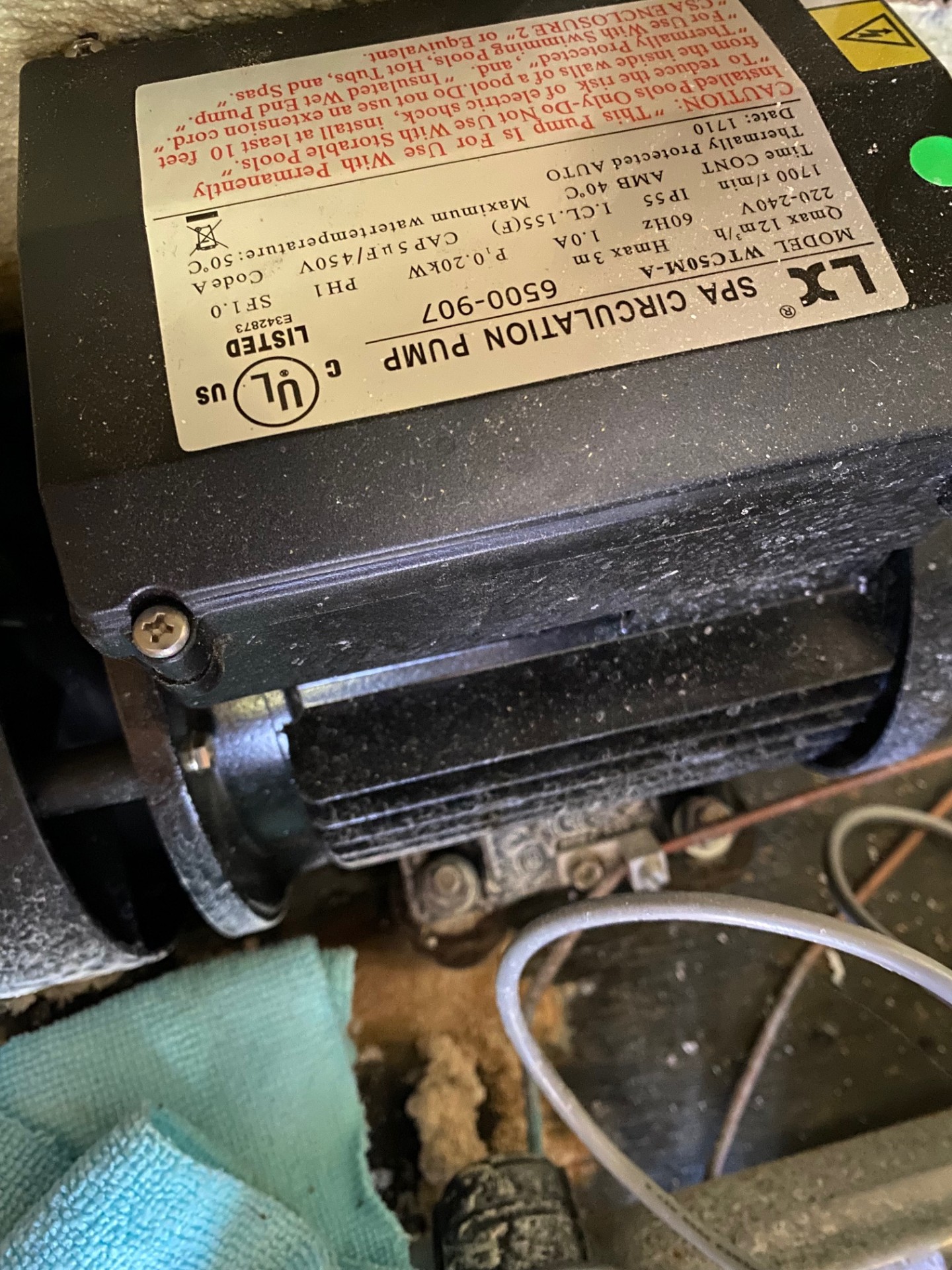

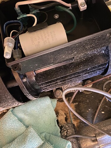

Please help to identify replacement capacitor for hot tub circulating pump motor
@donpitt111
I found the 399-16829-ND as an option.
C284ACA4500AL0J KEMET | Capacitors | DigiKey
The below link shows other options that we do have for the capacitance and voltage on the imaged item.
Motor Start, Motor Run Capacitors (AC) | Electronic Components Distributor DigiKey
