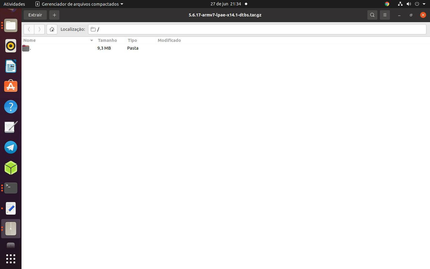

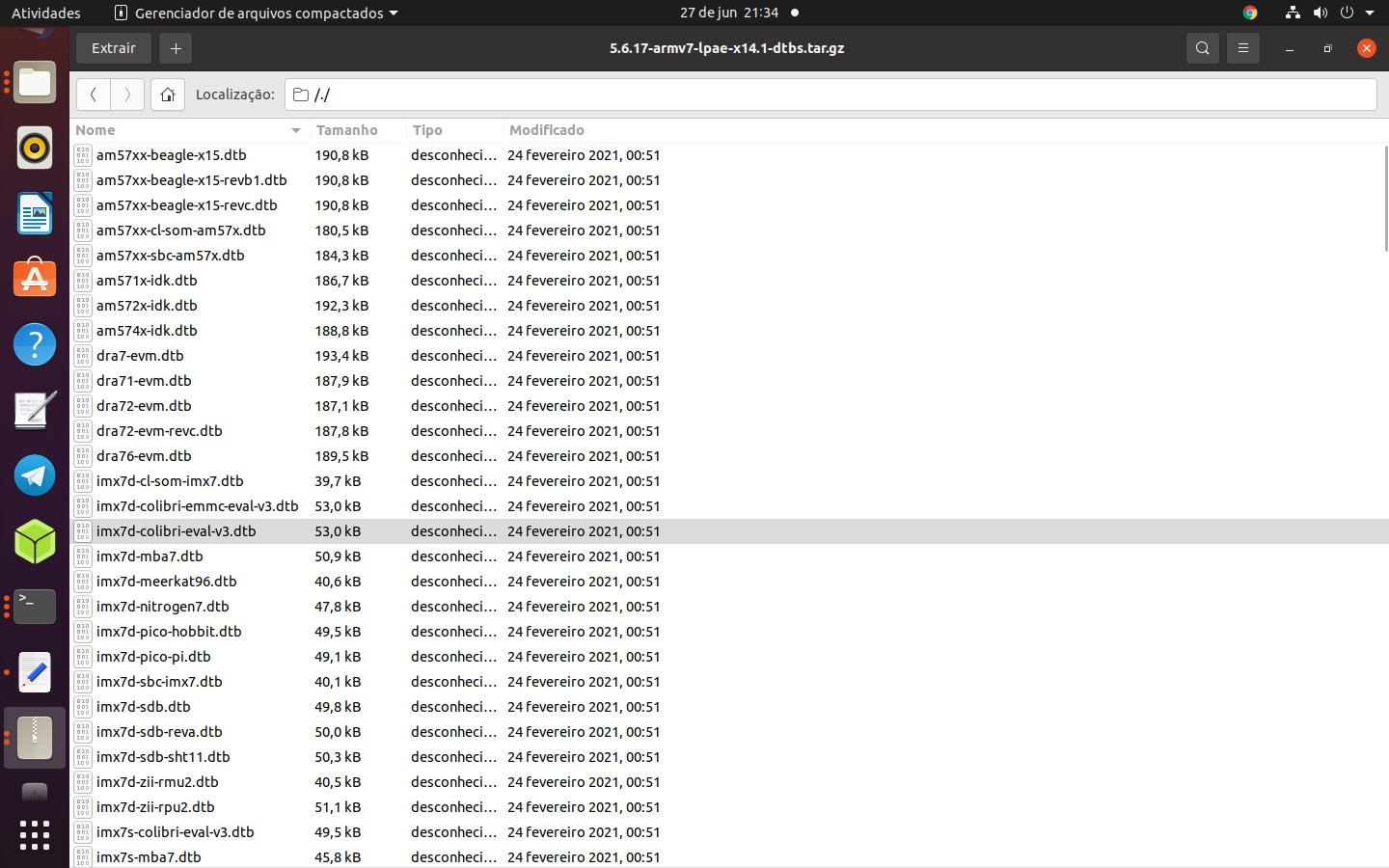

Hi,
I need help to change files (DTB) inside
5.6.17-armv7-lpae-x14.1-dtbs.tar.gz file.
Because As you can see in the pictures below, there is a folder called POINT above the level where the files in the folder are. Very difficult. already tried something
How would you like me to change the creation of the archive?
Compressing 5.6.19-armv7-lpae-x23-dtbs.tar.gz...
tar --create --gzip --file ../5.6.19-armv7-lpae-x23-dtbs.tar.gz ./*
Regards,

@RobertCNelson In last post (numerber 196) I said: "Using the command: tar --create --gzip --file …/5.6.19-armv7-lpae-x23-dtbs.tar.gz ./*
The correct for me is tar --create --gzip --file …/5.6.17-armv7-lpae-x14.1-dtbs.tar.gz ./*
Now I can blink LED(s) in debian10 with imx7d-pico board using libgpiod v1.4
