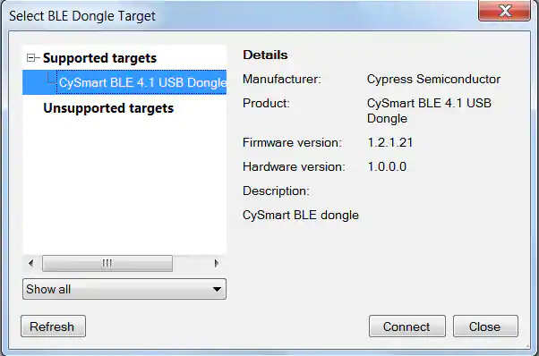

4. Open Cysmart 1.2 and connect to the dongle as shown below. If you have difficulties connecting to the dongle, I would suggest you take a look at this article: [Fixing Connection Issues between the Cypress CySmart Software and the CY5670 USB Dongle](https://www.eewiki.net/display/Wireless/Fixing+Connection+Issues+between+the+Cypress+CySmart+Software+and+the+CY5670+USB+Dongle)

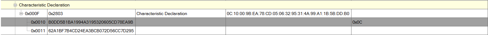

6. Once the device connects, click on the “Discover All Attributes” button. You should then see a screen similar to the following.

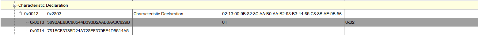

7. From there, scroll down to handle 0x0013. Select it. Once it is selected, click on the “Read Value” button toward the right of the Cysmart window. This will instruct Cysmart to read the value of the “Number\_Right” characteristic which should be 00
8. As stated earlier, we need to write to the “Number\_Write” service in order to increment the “Number\_Read” service’s value. To do this in Cysmart, click on handle 0x0010, enter a value in the value window and click the “Write Without Responding” button.
9. Now, read the “Number\_Read” characteristic as shown in step 7. The value should have incremented by 1. You can repeated steps 8 and 9 to continue incrementing the value.
