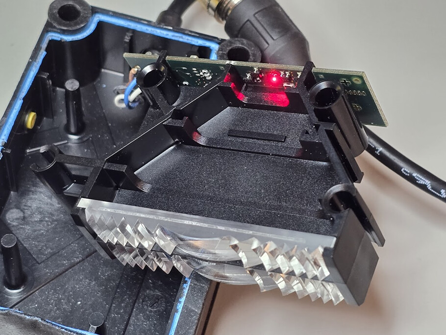

This educational post presents the teardown of an older phased out SICK WL27-3P3402S17 RAY26 reflex array sensor. The pictures show the sensor’s basic components with an emphasis on the lens used to produce a collimated light beam. Let’s begin with Figure 1, showing the sensor assembly removed from the protective case.
Figure 1: Image of a SICK reflex array sensor removed from its protective case.

Damage to the case. The adhesive holding the blue cover to the black case of the unit is very strong. Opening the case is like tearing the unit apart. The blue adhesive remnants are clearly seen in Figure 1. A damaged case will compromise the sensor’s IP67 rating resulting in shortened sensor life.
Components such as the PIC16F886 must be programmed. The microcontroller is almost certainly code-locked and few OEMs share the proprietary firmware.
The surface mount components aren’t excessively small, yet they require skill to replace without damaging the PCB.
As a common industry practice, few OEMs provide schematics. This is especially problematic with SMD components as the part numbers are often cryptic.
This is a classic miniaturization problem. Smart, small, and sealed are not repairable.
Tech Tip: Before you toss your SICK sensor, see if it is repaired by SICK or other authorized repair centers.

The SICK reflex array sensor uses a rectangular beam of light as shown in Figure 2. This beam is like a light curtain as opposed to the narrow beam of a conventional retroreflective sensor.
In Figure 2 we see that the light from the single visible red LED is focused into a collimated rectangular beam. It does this using a Fresnel-like lens (Figure 3), reminiscent of the maritime lighthouse lenses. This beam is then reflected by a “bicycle reflector” before returning to the light sensor via another lens. The amount of returning light is compared to a threshold to determine if an object is present.

Figure 4 shows the visible red LED along with the light sensor. Referring to Figure 1 we see how the LED light is formed into a rectangular beam. After reflecting, the light passes through another lens which focuses the returning light on the sensor.
Figure 4 also shows the PIC16F886 microcontroller. We can safely assume the microcontroller is used to establish the threshold sensitivity level for the received light beam. Refer to Figure 1, where we can just make out the yellow teach-in pushbutton plunger.
