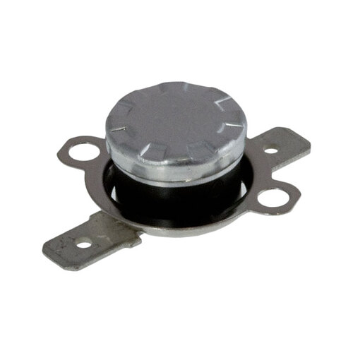

I’m looking to implement a cooling device (likely a Peltier-based Air conditioner fed with 12vDC) for equipment that overheats when exposed to the sun.
I want this cooling device to receive power whenever the temperature exceeds 15 degrees C.
Will the following component, placed inline, do the trick or are there better alternatives?
> **[CS701525Y | DigiKey Electronics](https://www.digikey.ca/en/products/detail/cantherm/CS701525Y/2195505)**
> Order Cantherm CS701525Y (317-1491-ND) at DigiKey. Check stock and pricing, view product specifications, and order online.
Thanks

Hello Shacazo,
Thank you for contacting DigiKey Technical Support.
I think you want a normally open switch NO, instead of a normally closed switch.
Part number [317-1489-ND](https://www.digikey.com/en/products/detail/cantherm/CS701515Y/2195503) will activate the cooler as long as device sensor is over 15C and it will be off on temperatures below 15C.

Thank you. That’s correct… it’s hard to understand what “open” and “closed” mean…
