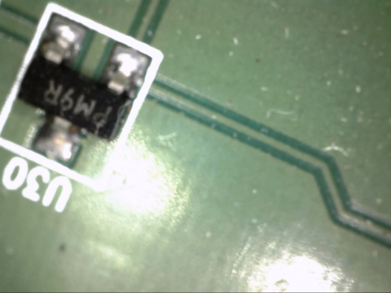

THANKS COLBY, BUT THEY ARE NOT, THEY ARE ALL DIFFERENT DEVICE IN SOT PACKAGES WITH EITHER 3 PIN OR 5 PIN LEADS ![aglw7JPEG](https://global.discourse-cdn.com/digikey/original/2X/6/687de69e74d314f969418bcf12cde093fab6dbc8.jpeg)
 ![F05JPEG](https://global.discourse-cdn.com/digikey/original/2X/3/31ea4e6a581fe6133aa8a52025b3d78ba5fb027f.jpeg) ![PM9RJPEG](https://global.discourse-cdn.com/digikey/original/2X/5/5c60241b4096151ab8b7979f01369c885e9a945e.jpeg)

**Author:** ![jamesyn](https://avatars.discourse-cdn.com/v4/letter/j/8baadc/32.png) [@jamesyn](https://forum.digikey.com/u/jamesyn)\
**Post date:** [April 30, 2025, 3:05pm UTC](https://forum.digikey.com/t/top-mark-device-marking/8285/6 "2025-04-30T15:05:33Z")
please check
for pm9r [https://ww1.microchip.com/downloads/en/DeviceDoc/11184d.pdf](https://ww1.microchip.com/downloads/en/DeviceDoc/11184d.pdf)
**Author:** ![Nathan\_2268](https://sea2.discourse-cdn.com/digikey/user_avatar/forum.digikey.com/nathan_2268/32/1883_2.png) [@Nathan\_2268](https://forum.digikey.com/u/Nathan_2268)\
**Post date:** [April 30, 2025, 3:13pm UTC](https://forum.digikey.com/t/top-mark-device-marking/8285/7 "2025-04-30T15:13:49Z")
@jamesdigikey
With the above linked document for the PM9R that @jamesyn gave I found the below.
MCP130T-450I/TT - As shown on page 6.
