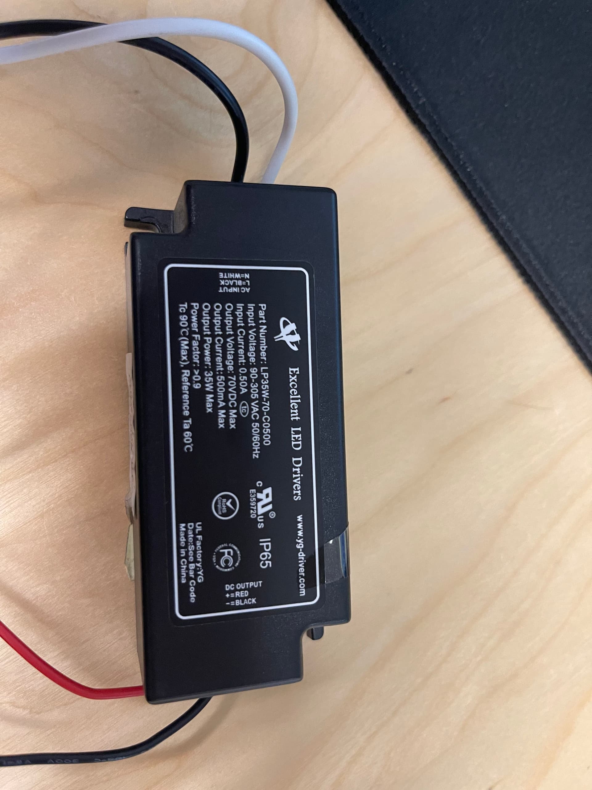

Good afternoon! I am trying to find a replacement LED driver, I’m sure it’s just me, but I can’t seem to find anything that is comparable. It needs to be 35w 90-305VAC 70VDC 500mA. I’ve checked the MeanWell APC, NHD & LDH series, some are close but way off in certain criteria. Do you have any suggestions?
The LED driver doesn’t explicitly callout constant current, but one of the options below should work as a replacement.
MFR PART # APC-35-500
DIGIKEY PART # 1866-1128-ND
MANUFACTURER MEAN WELL USA Inc.
DESCRIPTION 500mA 25 ~ 70V Constant Current LED Driver AC DC Converter Topology 1 Output
DATASHEET Click Here
MFR PART # PLD-40-500B
DIGIKEY PART # 1866-5396-ND
DESCRIPTION 500mA 45 ~ 80V Constant Current LED Driver AC DC Converter Topology 1 Output
