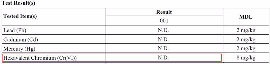

If you have any concerns regarding **excessive Cr (chromium) content** in part number [**AM16070006**](https://www.digikey.com/en/products/detail/txc-corporation/AM16070006/10670616?s=N4IgTCBcDaIIIFkCMA2ADAdjdlBhAKiALoC%2BQA) from [TXC Corporation](https://www.digikey.com/en/supplier-centers/txc), please refer to the following key points provided by the manufacturer for clarification:
1. **Material Composition** :
- The package ceramics used in this part contain **chromium oxide (Cr₂O₃)**.
- The **lid (Kovar)** and **electrode (Cr target)** also contain **chromium (Cr)**.
- Therefore, when tested using **XRF (X-ray fluorescence)** equipment, the test will definitely result in exceeding the standard, which is normal/expected.
1. **Type of Chromium Detected** :
- XRF instruments detect the **“chromium element”** , **instead of hexavalent chromium (Cr⁶⁺)**, which is the substance regulated under RoHS.
- As shown in the **test report** , the **hexavalent chromium (Cr⁶⁺) in our AM products is “ND” (Not Detected)**, which **meets RoHS requirements**.
Please be aware of these two important distinctions to avoid confusion.
For reference, the **test report is attached** to support this explanation.
