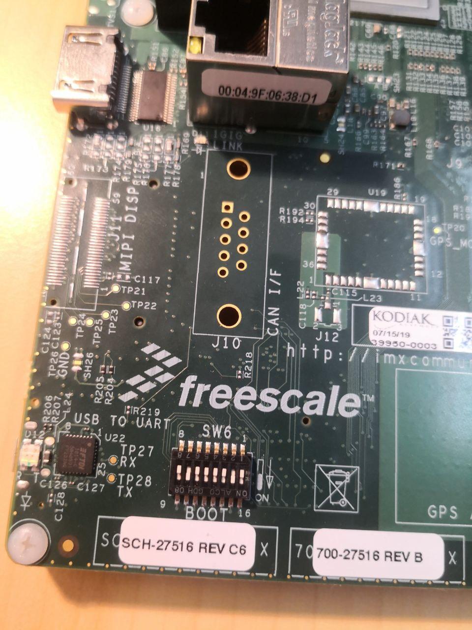

Hi @shinwano,
Can you please take a camera shot of the jumpers on your board and share in this thread?
Looking at the board, I believe this had a weird situations with the micro USB port where two usart’s would show up on your development pc. You must also push the power reset button to get it to start.

Hi Robert.
Thank you for your response.
I have attached some shots of my board but I’m fairly sure that it is not the boot jumpers or my serial port. Like I said, The SDcard that shipped with the board boots just fine and I can see the u-boot prompts and the kernel messages and everything (without changing anything to do with the serial or the boot jumpers).
I am using ubuntu 18.04 on a VMware workstation virtual machine to build the u-boot. but im using putty on windows for the serial output.
I think something must be wrong with the u-boot or the SPL that i built. but I’m not sure what.
EDIT: I forgot to respond that i do press the reset button every time the image doesnt boot. still does nothing.
