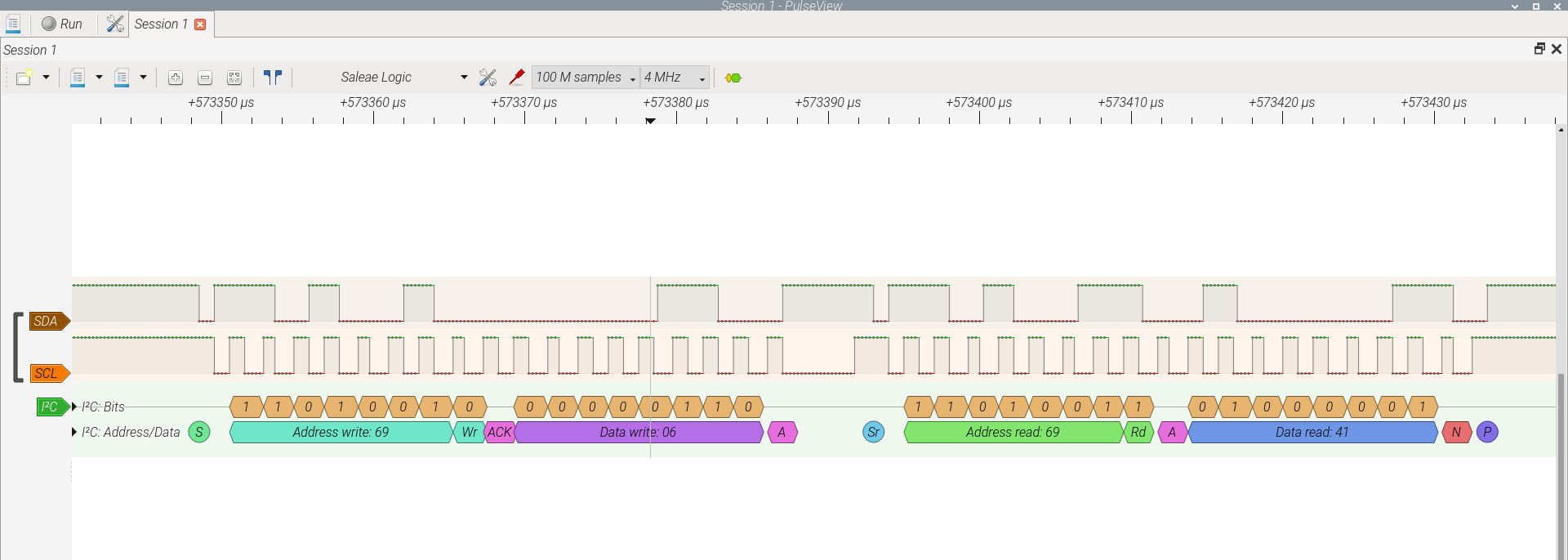

The Sparkfun [8-channel USB Logic Analyzer](https://www.digikey.com/en/products/detail/sparkfun-electronics/18627/15842546) previously described in this [Techforum article](https://forum.digikey.com/t/sparkfun-usb-logic-analyzer-with-installation-steps-in-linux-os/60392) was setup as shown in the next picture [using these Qwiic cables](https://www.digikey.com/en/products/detail/sparkfun-electronics/15081/9770723?_gl=1*x6axrz*_gcl_dc*R0NMLjE3NTk5NTI4NTAuNmFkNjk3NzNlOTAwMTI3ZWZlODdmZjk1NTZjYTA2ZWQ.*_gcl_au*MTczMjkxNTg5OC4xNzUzMTI5NTQ4) to monitor the I2C bus using the proper voltage source, PIN6 (SDA), PIN7 (SCL) (I2C Port 0) and PIN 38 (GND) on the [Raspberry Pico 2](https://www.digikey.com/en/products/detail/raspberry-pi/SC1631/24627136) as shown below,

The Sparkfun [8-channel USB Logic Analyzer](https://www.digikey.com/en/products/detail/sparkfun-electronics/18627/15842546) was connected to the SCL, SDA (I2C bus signals) and the GND (Ground) as shown above (Not the optimum way of connecting it due to long cable runs, increased first order lumped RC time constant, etc, perturbation of the I2C bus). Now proceed to flash the Zephyr OS application into the [Raspberry Pico 2](https://www.digikey.com/en/products/detail/raspberry-pi/SC1631/24627136)
```auto
(venv) $ west flash --runner uf2
In the minicom terminal the output will display from the [Raspberry Pico 2](https://www.digikey.com/en/products/detail/raspberry-pi/SC1631/24627136) the following,

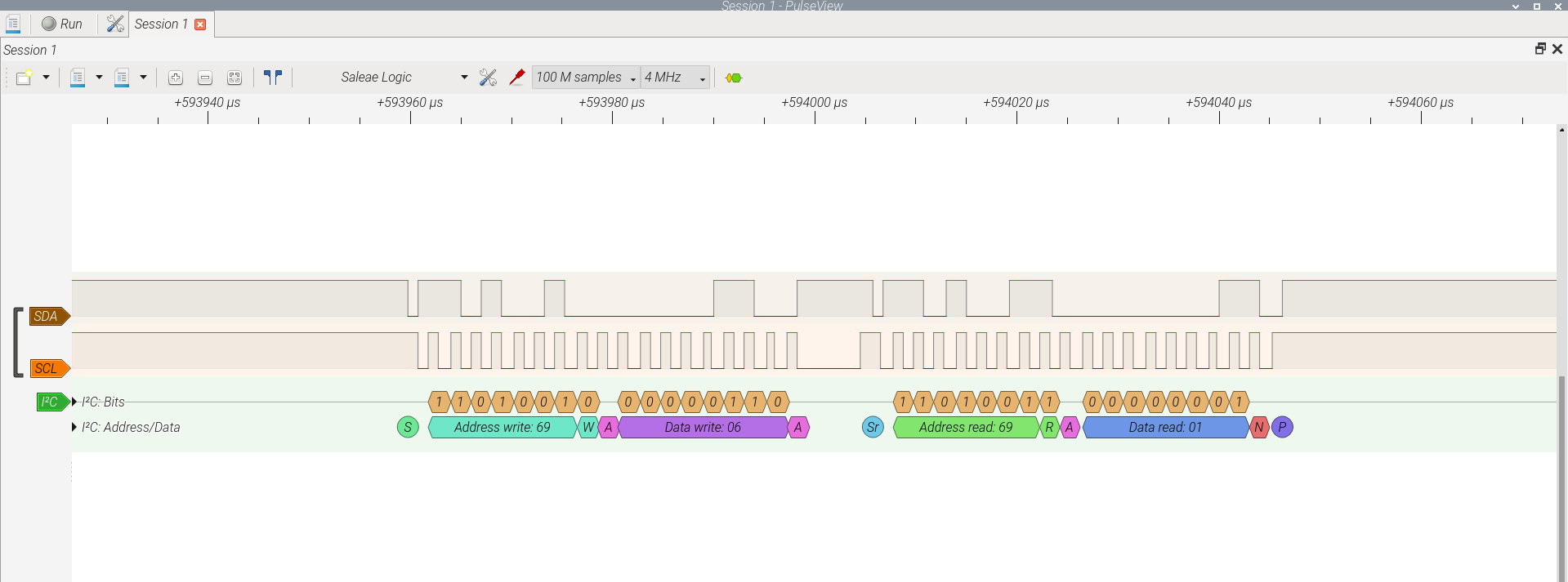

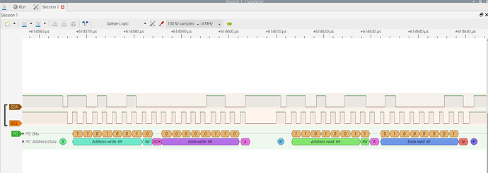

The Sparkfun [8-channel USB Logic Analyzer](https://www.digikey.com/en/products/detail/sparkfun-electronics/18627/15842546) confirms that this Zephyr C program running inside the [Raspberry Pico 2](https://www.digikey.com/en/products/detail/raspberry-pi/SC1631/24627136) using only the I2C definition in the Zephyr OS overlay works. The proper sequence I2C interface I2C\_MSG\_WRITE, I2C\_MSG\_WRITE, I2C\_MSG\_STOP defined in the main.c developed here at Digikey for the I2C write internal finite state machine is followed. Also the I2C\_MSG\_WRITE, I2C\_MSG\_RESTART, I2C\_MSG\_READ, I2C\_MSG\_STOP of the I2C read internal finite state machine is followed. The next logic analyzer snapshots, show what is happening inside the I2C bus interface as the Zephyr C program running inside the [Raspberry Pico 2](https://www.digikey.com/en/products/detail/raspberry-pi/SC1631/24627136) is interacting with the sensor,

The sequence of proper I2C read/write transactions are confirmed by the logic analyzer on the I2C bus to the slave device. The WHOAMI register is read in the loop, changes to the PWR\_MGMT\_1 register are performed to place it in awake mode or sleep mode (in sleep mode all analog is powered off).
