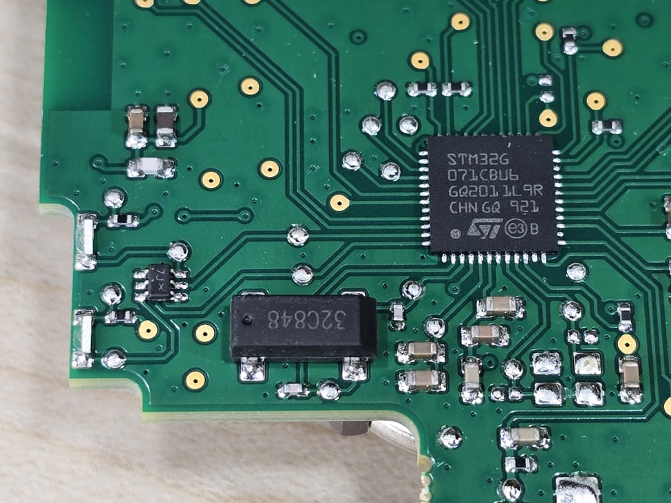

When I first opened the Crouzet, there were two main components that caught my attention while looking for which components supported the Real-Time Clock.
Figure 3: Bottom View of the Crouzet Slim’s Logic PCB
These components include the previously mentioned STM32 microcontroller and a 32C848-marked component. This chip was a little difficult to identify at first, since a specific datasheet did not appear when searching its chip markings. Instead, I chose to try and identify the chip’s functionality by tracing where the chip connects to the STM32 microcontroller’s pinout. This led to finding that the chip matches up to pins 3 and 4, which are the pins that act as the oscillator IN and OUT pins according to the STM32 microcontroller’s datasheet.
Figure 4: Schematic of the Real-Time Clock functionality
Finding this made it clear what the functionality of the 32C848 chip was. It is a 32 kHz crystal that acts as a timing reference for the Real-Time Clock, labeled RTC on the schematic. The schematic even shows that the clock is powered by VBAT, which would be the battery. This agrees with our previous findings as it would be why the clock reset after the battery is removed and reinstalled.
