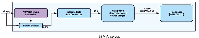

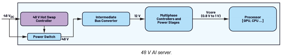

[**Hot swap controllers**](https://www.digikey.com/en/products/filter/power-management-pmic/hot-swap-controllers/718) are the first components in a system’s power path, which makes them well-suited for monitoring and data collection.
They must accurately measure voltage, current, and power to ensure the system operates within its specifications. Additionally, they should be able to detect and log critical events such as overcurrent, undervoltage, and thermal shutdowns. It’s also important for them to report temperatures from the power switch (MOSFET) or nearby PCB areas.
 ![image](https://global.discourse-cdn.com/digikey/original/3X/1/f/1ff02c80ccc17e966d4baaa819128ee024d0c5f9.png)
**Accurate hot swap telemetry** enables real-time load current profiling, which improves energy demand forecasting. It supports predictive maintenance, event logging, and load profiling, helping data centers improve uptime and optimize energy planning.
