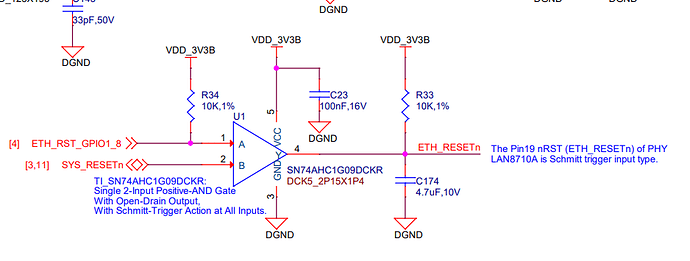

Ethernet device is not detecting on ubuntu 20.04 LTS on BBG
I enabled CONFIG_TI_CPSW_SWITCHDEV and verified seems like it did not fix the problem. Below is the log.
~$ dmesg | grep mdio
[    3.039021] davinci_mdio 4a101000.mdio: davinci mdio revision 1.6, bus freq 1000000
[    3.039057] libphy: 4a101000.mdio: probed
[    3.039352] mdio_bus 4a101000.mdio: MDIO device at address 0 is missing.
Adding detailed log for reference

Please provide your suggestions/ input.
Thanks
Correct, that config doesn’t fix it… It’s just the new driver…
Like i said, TI changed the cpsw driver on AM335x…
The work-around patch only works with the older pre TI_CPSW_SWITCHDEV driver…
Right now, your best options are to use v4.19.x or 5.4.x…
Or pick-up a new BBB with a hardware fix. This issue only affects a small percentage of boards.

mdio phy address…
The address physically set by the pull-up resistors, the PHY fails to correctly read at power up…

^ it came up normally there…
[ 3.646307] davinci_mdio 4a101000.mdio: detected phy mask fffffffe
[ 3.646662] davinci_mdio: dt: updated phy_id[0] from phy_mask[fffffffe]
With the workaround, you’ll see ^ above, as the phy_id was wrong…

For the BeagleBone Green, to date there has only been one design in the market.
First device with the mdio fix is the BeagleBone Black (RevC3)… GitHub - beagleboard/beaglebone-black: Design and Document files for the BeagleBone Black from BeagleBoard.org
Regards,
Thanks, Robert for your quick reply.
Can we apply the same fix to BeagleBone Green? if yes, could you please provide more details regarding the hardware changes?
Appreciate your valuable input.
Thanks,
Mrudula
You can see the fix on page 9… Prior SYS_RESET was connected to nRST on the LAN8710A, the fix was to add a gpio controlled reset option. This allows us to reset the PHY on startup.
BEAGLEBONEBLK_C.pdf (72.4 KB)
beaglebone black_sch_revc3_2104.pdf (204.7 KB)
Regards,
Hi Robert,
Thank you very much for sharing the details. We will try making the above changes on Beaglebone green on our side.
