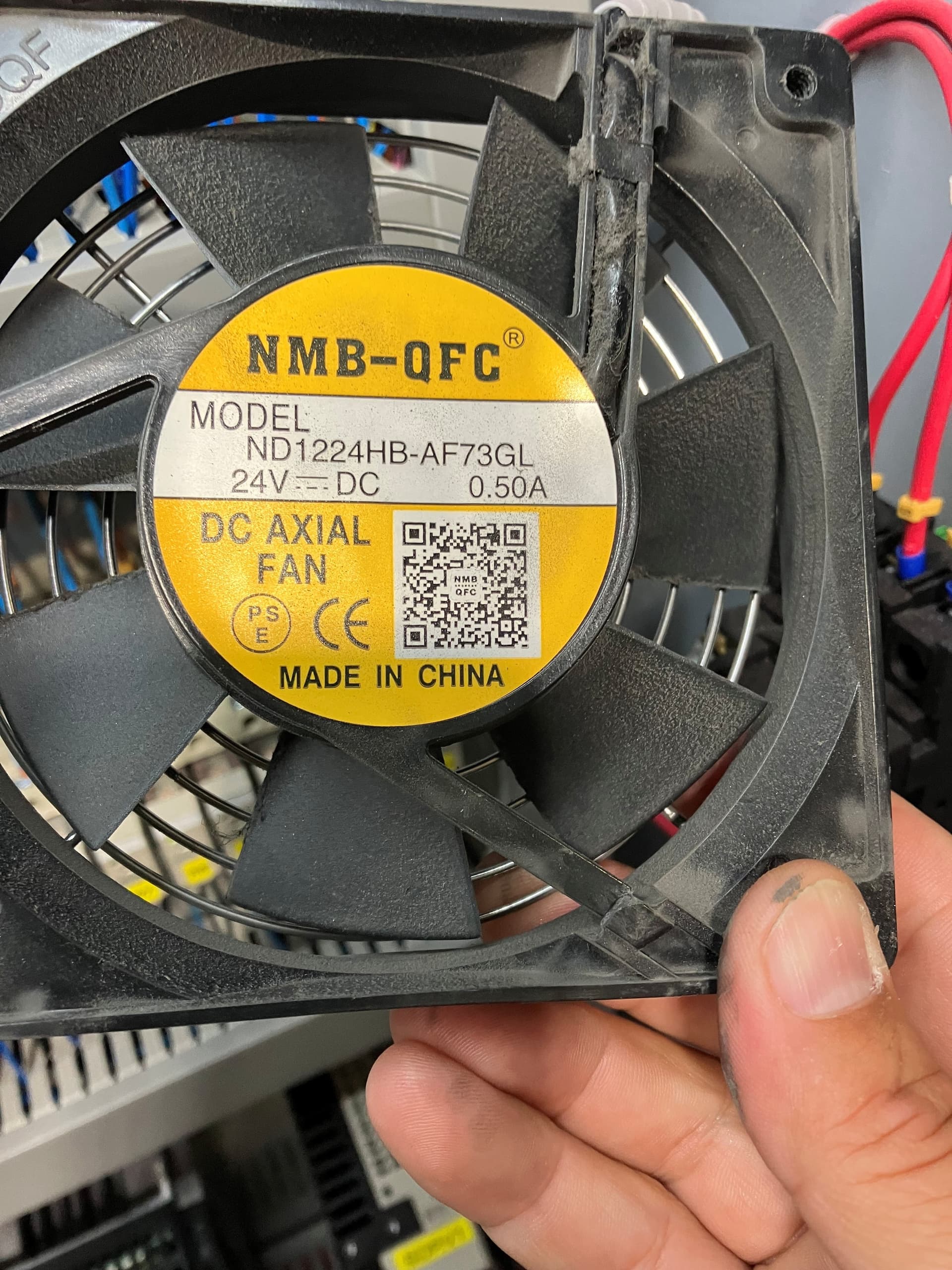

Looking for a replacement for the fan attached. Having a heck of a time trying to navigate NMB website. Is this available on DigiKey, or perhaps a suitable alternative. Thanks for the help.

I do not see that there is much information available for this fan. It might be that it was a custom fan for the OEM of the product that this was in. How many wires are there for the fan? Is the fan size 120mm x 120mm and what thickness? Is the fan for only air inlet or outlet or is it against a heatsink?
From looking online that fan looks to be 120mm by 120mm square at 25mm thickness.
I could not find any more specifications on it other than what is listed on that label in your picture.
If you can verify if it is 2 wire or more and select from the following list based on what you know of the fan like RPMs and airflow, and number of wires.
Fan is a simple 2 wire. It is being used for electrical cabinet ventilation. It is not against a heat sink. I will take a look at the link provided. Appreciate the help.
2 wire ones from that list that are in stock.
