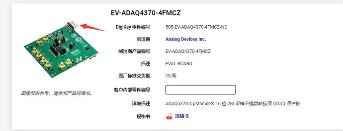

For Analog Devices part number EV-ADAQ4370-4FMCZ we have recieved inquiries about if this board should include the 12 position Right Angle Header pictured below:

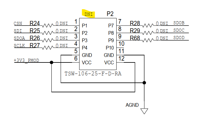

The answer to this question is the board does not come with this header populated, both the Bill of Materials and board Schematic indicate that this component, along with the jumpers connected to it, are DNI which stands for Do Not Install.
If you need this connector it can be ordered here:
TSW-106-25-F-D-RA Samtec Inc. | Connectors, Interconnects | DigiKey
The jumpers can be purchased here:
ERJ-2GE0R00X Panasonic Electronic Components | Resistors | DigiKey
