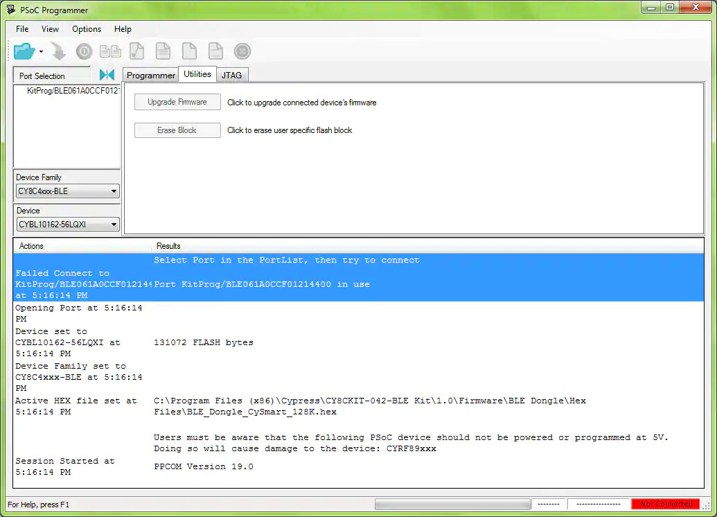

Problem 3 - Unable to Connect to USB Dongle via PSoC Programmer
Likely to have followed problem 2, when attempting to connected to the CY5670 USB Dongle through PSoC Programmer to reprogram the CYBL10162-56LQXI PRoC BLE chip with the file indicated by the pop-up, PSoC Programmer is unable to connect to the dongle. Even after closing all other programs, or even rebooting the computer, the problem persists.
A pop-up message indicating the programmer needs its firmware updated may have displayed, but even after performing the actions listed in problem 4 below the issue persists.
Problem 4 - Attempting to Upgrade Firmware of the CY5670 USB Dongle via the PSoC Programmer Utilities Tab Unsuccessful
This problem includes the “Upgrade Firmware” button being greyed out and unable to be clicked, or that when clicked the firmware upgrade is successful, but any of the previously described problems persist.
This problem also includes both the case of attempting to upgrade the CYBL10162-56LQXI PRoC BLE firmware (dongle was plugged in normally), and the case of attempting to upgrade the CY8C5868LTI-LP039 PSoC 5LP programmer and debugger firmware by holding down the “RESET” button on the CY5670 USB Dongle when it is being plugged in so that “LED2” on the dongle flashes green.

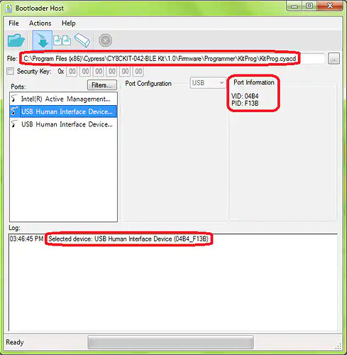

Step 1 - Update the CY8C5868LTI-LP039 PSoC 5LP Programmer and Debugger Firmware via the PSoC Creator Bootloader Host Tool
First run the CY8CKIT-042-BLE Kit Complete Installation if it has not previously been done. Even if this isn’t the particular kit being used, it will provide access to all the files and software necessary for the subsequent steps.
Open “PSoC Creator” from the “Windows, All Programs” menu.
After PSoC Creator opens, select the “Bootloader Host” option from the “Tools” menu.
Now plug in the CY5670 USB Dongle while holding down the “Reset” button on the dongle. If done correctly, “LED2” on the board should flash green.
Inside the Bootloader Host tool, it may be necessary to click on the small “Filters” button above the “Ports” list, and then to clear the “VID” and “PID” entry fields in the pop-up menu before clicking the “OK” button.
Ultimately, the goal is to select the “USB Human Interface Device” that matches the “Port Information” below. Once this is done, open the indicated file at the path listed below, or at whatever location the CY8CKIT-042-BLE Pioneer Kit software was installed. Finally, click the “Program” button.
If successful, the text in the “Log” should update to indicate this, and “LED2” on the dongle should stop flashing.
