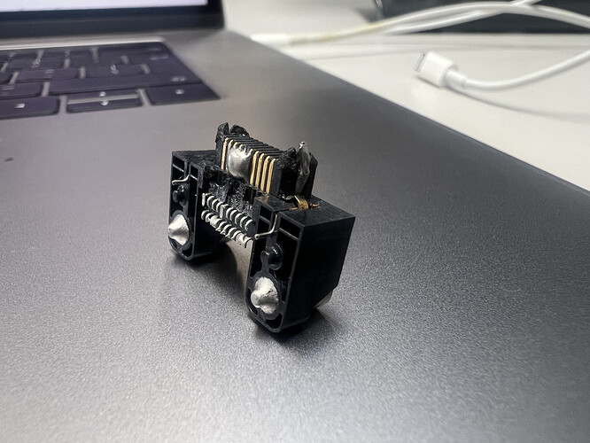

I need help finding the correct part number for the male connector
I bought the ERM8-010-01-L-D-RA-K-TR male connector, but this specific model in the datasheet has the side pins that connect to the female plug, but the model I purchased doesn’t. I need help selecting the correct connector.
Hello geral,
To add the latches, the part breakdown shows an added -L after the RA in the part number.
Click Here for the parts in our system with the latch feature. We do not have any of these in stock, but they can be ordered.
The best option I found is part number 612-ERM8-010-01-L-D-RA-L-TRCT-ND, which has the latches, but not the pick and place pad. If you are just replacing one, you wouldn’t need the pad anyway. You can contact our Sales department to check on the lead-time to get it. You can call them at 1-800-344-4539, or email them at Orders@digikey.com.
